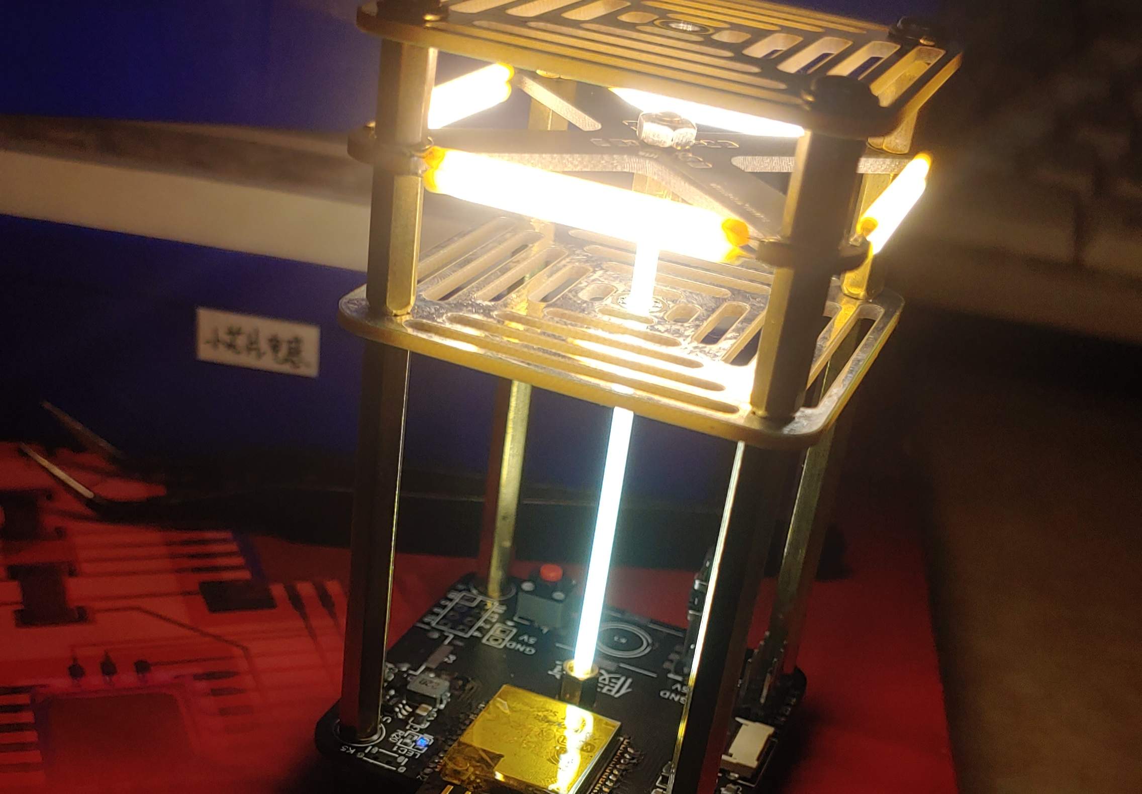

ESP32 desk lamp
An ordinary desk lamp with adjustable brightness, there is an ESP32... I use the mouse wheel to adjust the brightness (very low cost performance)
(Rendering of a rudimentary version)
Copper pillars are used to connect the layers. To prevent foolproofing, only the central copper pillar is powered, and the surrounding ones are grounded.
Because each light panel is connected in parallel, the number of light panels can be adjusted arbitrarily, and light panels of different colors can be freely replaced to create different atmospheres, such as the green one in the picture below:
It can also be combined in fancy ways, like this:
The SY7201 constant current boost LED driver is used, which supports up to 30V. The driving current is limited, so it is best not to add too many lights. Three layers will be very hot. The inductors and resistors corresponding to the light boards with different layers are as follows:
