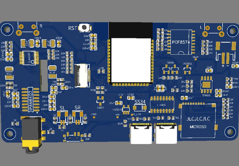

Secondary design based on the open source project ESPlay
Updated on 2022-8-24

Replace the parallel LDO with 1A DCDC. One of the parallel LDOs will be very hot when starting up. For the sake of stability, replace it. The screen package has been repaired and has been shipped by express. It should be the final version.
Updated on 2022-3-1
The board has been soldered, the headphone holder packaging error has been corrected (it is now a PJ-342 package), the switch packaging has been replaced, the problem that the battery interface is too far up and cannot be inserted has been corrected, the audio string resistor has been removed, and the test program has not been written yet.
The hardware design of this project comes from esplay_micro_hardware of master pebri86
Project address: https://github.com/pebri86/esplay_micro_hardware
This project refers to the LiiGuang boss project and uses some component locations.
Original project address: https://oshwhub.com/LiiGuang/esplay-micro-V2
The hardware replaces the old ESP32 with the latest ESP32S3
Modified some schematics and simplified some circuits
The audio series resistor can reduce the volume, or a direct 0 ohm resistor (a piece of tin will also work) should be able to further reduce the sound through software control. It has not been tested yet. If it works, the resistor will be deleted.
JP jumper welding 0 ohm resistor, specific use unknown
Hardware design completed, waiting for board verification
The program progress is 0.1% (currently writing BL in CV programming). I asked the RetroESP32 bosses on github if they have any ideas to transplant RetroESP32 to S3.
It is recommended to use ESP32 S3 D2N8R8 module, 8M Flash and 8M PSRAM. Although 8M PSRAM may not be used up, large memory has more redundancy.
The speakers use the upper and lower speakers of Xiaomi 10Pro. In actual testing, they can be used normally and the volume is very loud.
