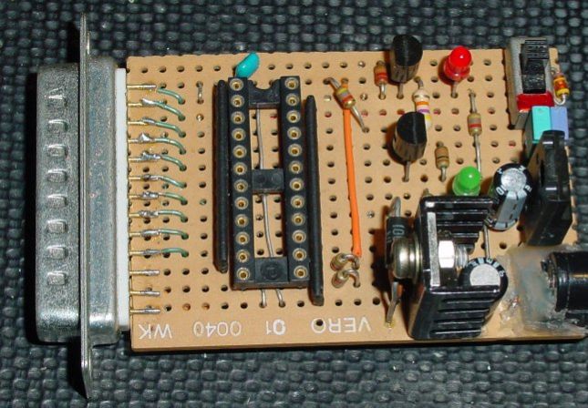

A high-voltage parallel programmer for simple gal logic gates. It is written with turboc++4.5. Because it needs to use dos and bios interrupts (I have always loved dos interrupts), it supports up to winnt5.1 (xp32 bit). If you are interested, you can Try running it under win3.2, and it still works. The lpt printing port must be the one that comes with the motherboard. Otherwise, there is no preloaded irq in the bios, and of course it won't work. At that time, it took a lot of effort to check the chip manual for the flag bits, and I wrote 1940 lines of code alone.
