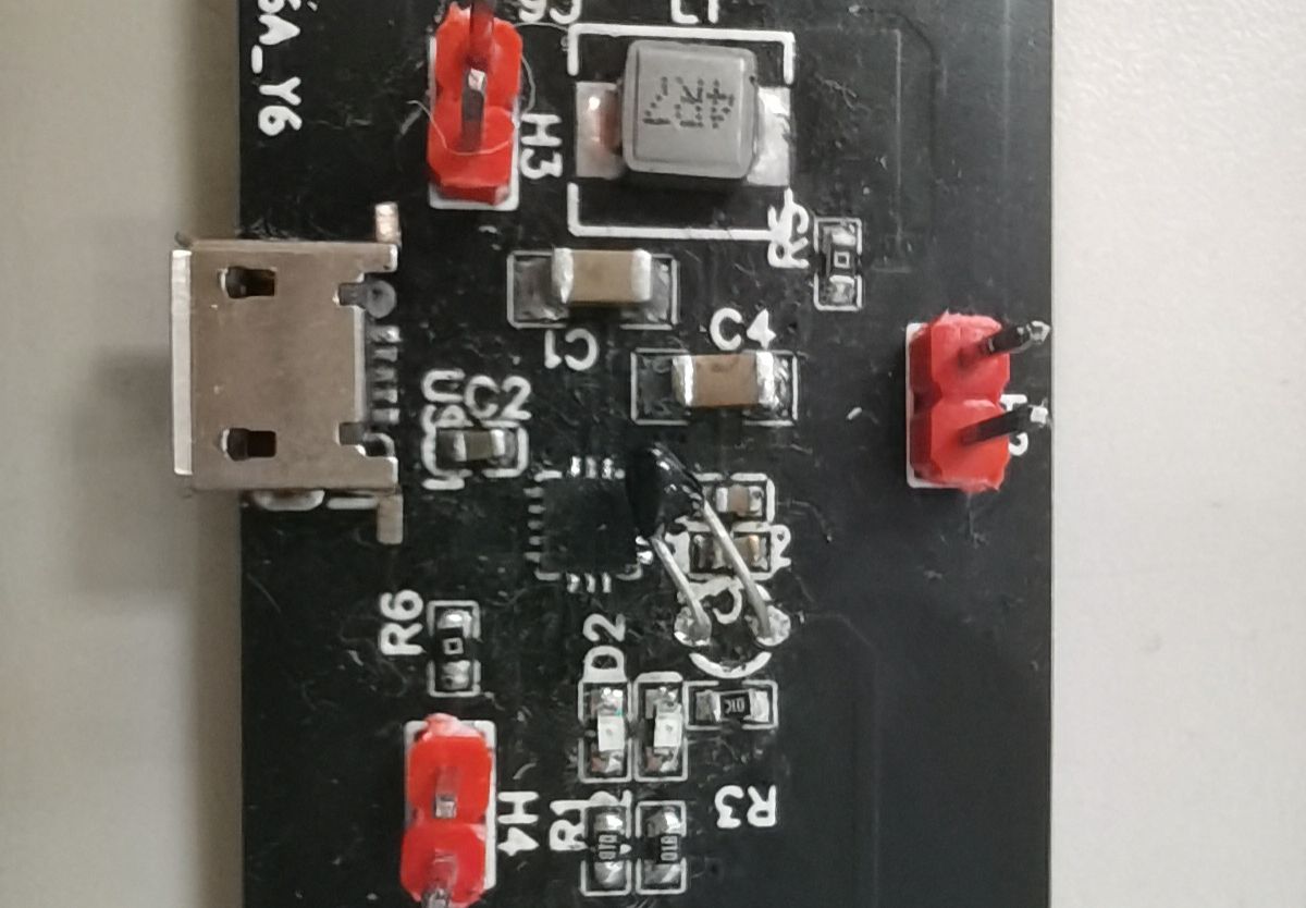

Use TPS61088 to boost the voltage of lithium battery. and MP2615 for charging lithium batteries. An external wireless charging module can meet wireless charging needs. This module can be used to meet the fast charging requirements of large-capacity lithium batteries. The maximum charging current is 2A, and it can accept a wide range of voltage inputs. The boost module can realize the voltage conversion of a single lithium battery between 5V and 12V. The maximum load that the lithium battery can carry Power output, 12V0.5A and 5V2A, can be satisfied if the lithium battery has excellent output capability.
