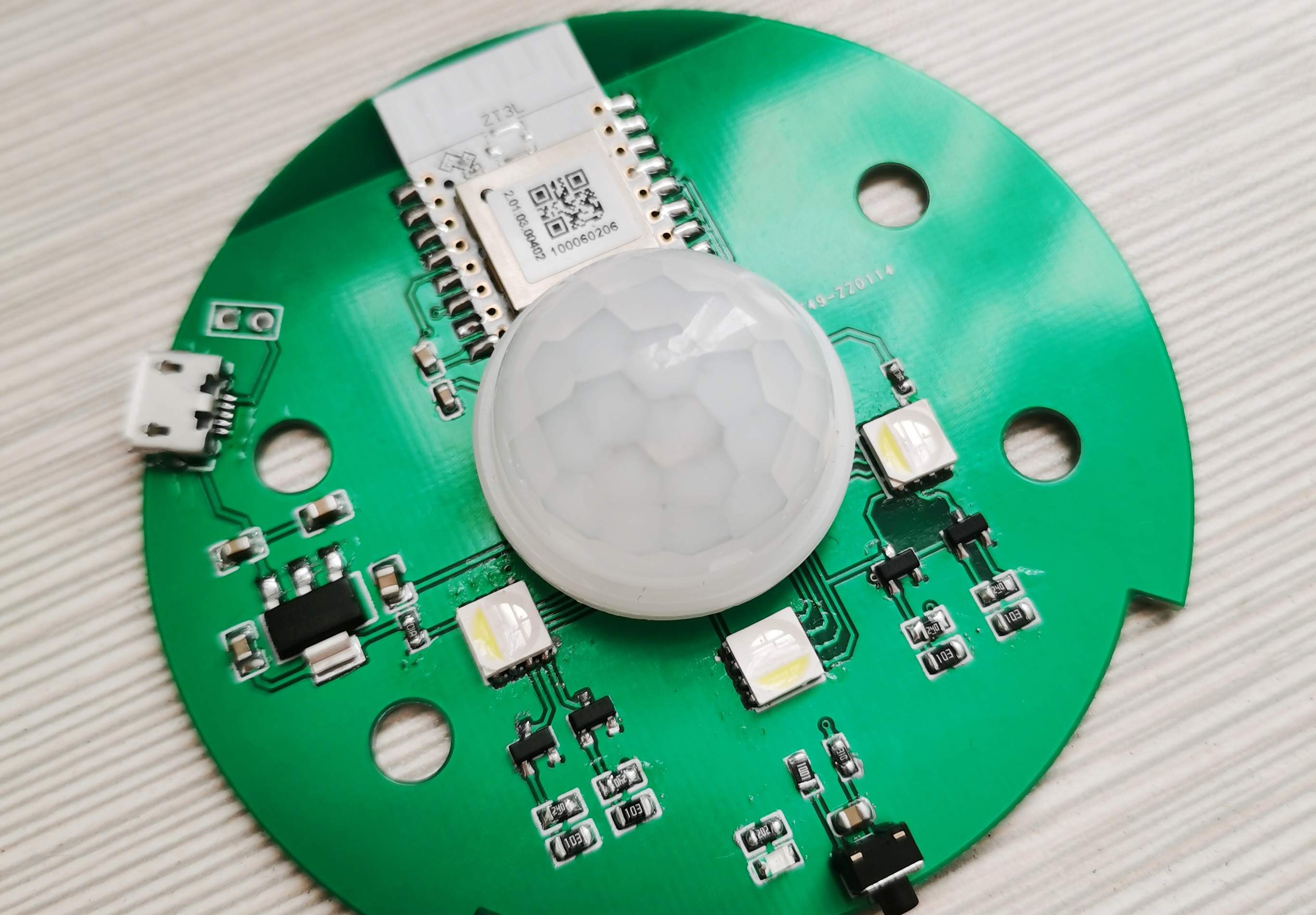

1. This project uses RGBC sensor lights made with Tuya Zigbee (ZTU) modules, which can not only be linked to other smart homes, but also require no development or coding;
2. This thermometer and hygrometer has functions such as light timing, customized lighting and linked alarms, and the triggering time is variable;
3. This module consumes less power and can be connected to a battery for power supply.
Thank you very much for @ yanqisui 's great help and the shell file of user shouji6406 on the site , which made the PCB a comfortable home:)
For the specific creation process, you can click the OEM link above to clone and create it yourself. For firmware configuration, please see the attachment at the end of the article.

PCB display:
Only white light on:
Q1: PCB Note:
RGBC lamp beads are easy to solder, please make sure they are soldered correctly;
The 10k adjustable resistor can be replaced with a 0805 0 ohm resistor, which functions as a manual delay adjustment;
The shell is a transparent white shell.
Q2: Function Note:
Due to the unofficial sensor module used, it cannot be used: motion detection and light control mode, but the detection is sensitive.
Q2: How to configure the network?
After the device is powered on, you need to press and hold the network distribution button to enter the network distribution mode. During the network distribution process, you need to manually operate the gateway to search. At this time, you only need to open the gateway in the Tuya Smart APP and enter automatic search to find that the device has completed network configuration (note: some mobile phones need to enable positioning and other permissions ). Other modules are determined according to the options you configure the module firmware at that time.
