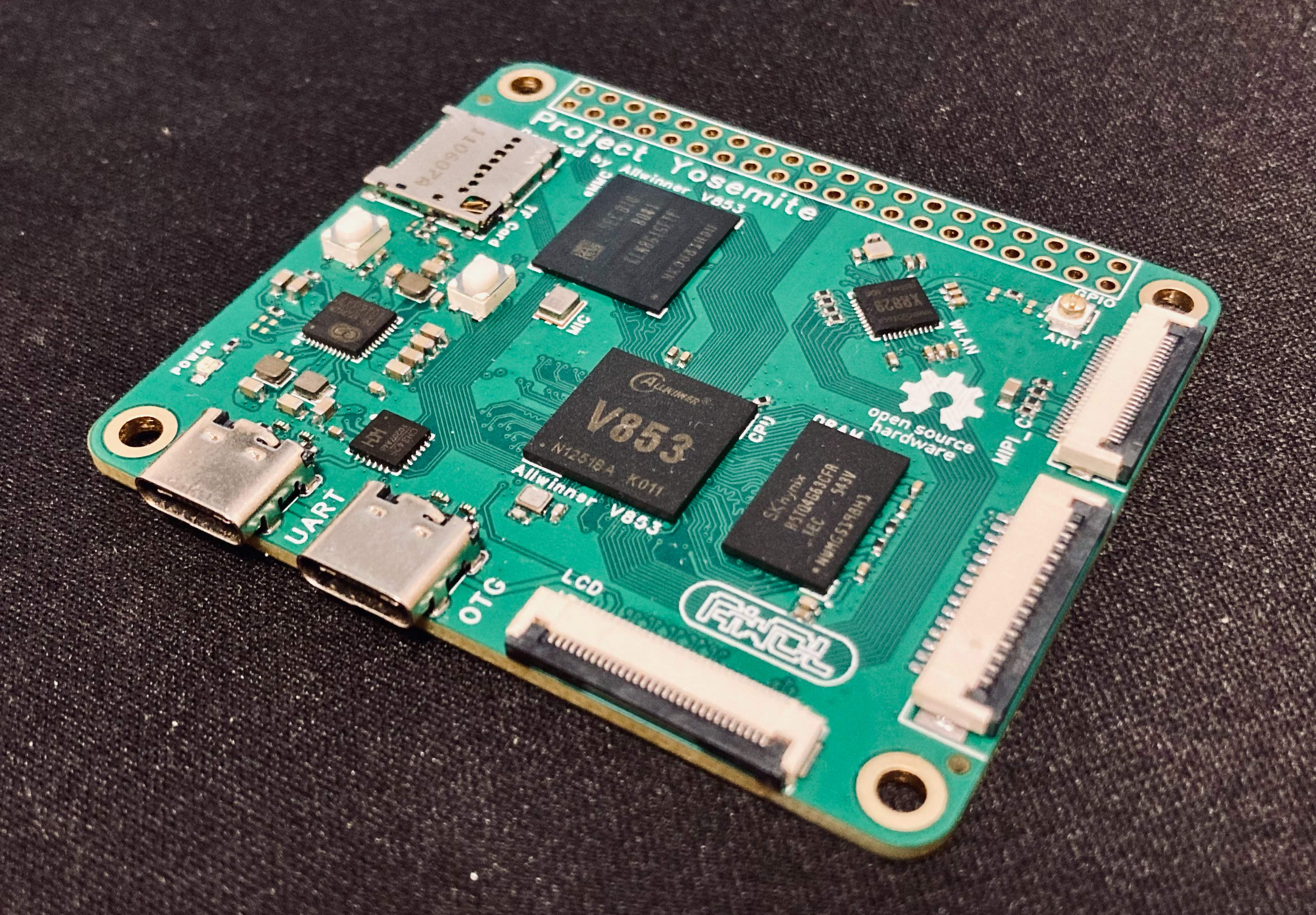

High-performance heterogeneous edge AI vision development board Porject Yosemite
Porject Yosemite
High-performance heterogeneous edge AI vision processing core development board
  • Raspberry Pi A version, leading to 40Pin IO
  • With MIPI DSI screen interface, supports 1920x1200 resolution MIPI screen, supports capacitive touch
  • MIPI CSI camera interface and Raspberry Pi camera interface, supporting 1080p dual camera and 4k single camera
  • Support H.264/H.265/JPEG hardware encoding and decoding
  • Onboard XR829 WIFI Bluetooth chip
  • Onboard eMMC, supports up to 256GB
  • Support TF card boot and eMMC boot
  • Onboard USB to dual UART chip supports simultaneous heterogeneous debugging of Arm core and RISC-V core
  • With 1Tops NPU, supports TensorFlow, Caffe, Tflite, Pytorch, Onnx NN and other models
resource
Allwinner V853
V853 is a new generation of high-performance, low-power processor SOC launched for the field of intelligent vision. It can be widely used in intelligent upgrade-related industries such as intelligent door locks, intelligent attendance and access control, network cameras, driving recorders, and intelligent desk lamps. .
V853 integrates Arm Cortex-A7 and RISC-V E907 dual CPUs, has a built-in NPU with a maximum computing power of 1T, uses Allwinner's self-developed Smart video engine, and supports up to 5M@25fps H.265 encoding and 5M@25fps H.264 encoding and decoding. Integrated high-performance ISP image processor can provide customers with professional-level image quality. V853 also supports 16-bit DDR3/DDR3L to meet the high bandwidth requirements of various products; supports 4lane MIPI-CSI/DVP/MIPI-DSI/RGB and other rich dedicated video input and output interfaces to meet the needs of various AI vision products; adopts advanced The 22nm process has better power consumption and smaller chip area.
Hardware related
Please select JLC3313 stacked impedance when placing an order. The default JLC7628 impedance stacked for testing cannot initialize DRAM.
Verified features:
  • DDR3@1866 512M
  • TF mounting and starting
  • eMMC start
  • GPIO usage
  • i2c, SPI function
  • WLAN, WiFi BT
  • UART adapter chip
  • MIPI CSI
