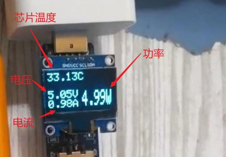

1. Project function introduction:
USB power meter, 1% accuracy, 0.96-inch OLED display (official 0.91-inch), can view current, voltage, power, chip temperature, does not support fast charging version, maximum measurement 6V, 2.8A.
2. Hardware
schematic drawing:
AMS1117-3.3V is used for power supply, and the circuit provided by the chip data sheet can be viewed in the external circuit.
Main control circuit: Refer to the "N32G430C8L7-STB Data Sheet" of LiChuang Mall to draw the external circuit, mainly including the chip's input power supply filtering, external crystal oscillator 8MHZ, reset, BOOT0, download and debug interface circuit, etc.
Voltage sampling: Use the voltage division principle for AD sampling. It should be noted that the sampling resistor here needs high precision.
Current sampling: Use INA199A1DCKR, voltage output, current shunt monitor (also known as current sensing amplifier) ​​is often used for overcurrent protection, precision current measurement for system optimization or closed-loop feedback circuit, and the gain used here is 50V/V.

3. Software part (Note: This program does not require soldering of the crystal oscillator, but uses an internal clock)
Use the official program code to add an internal temperature sensor (see the attachment for the code)
Screen code modification:
