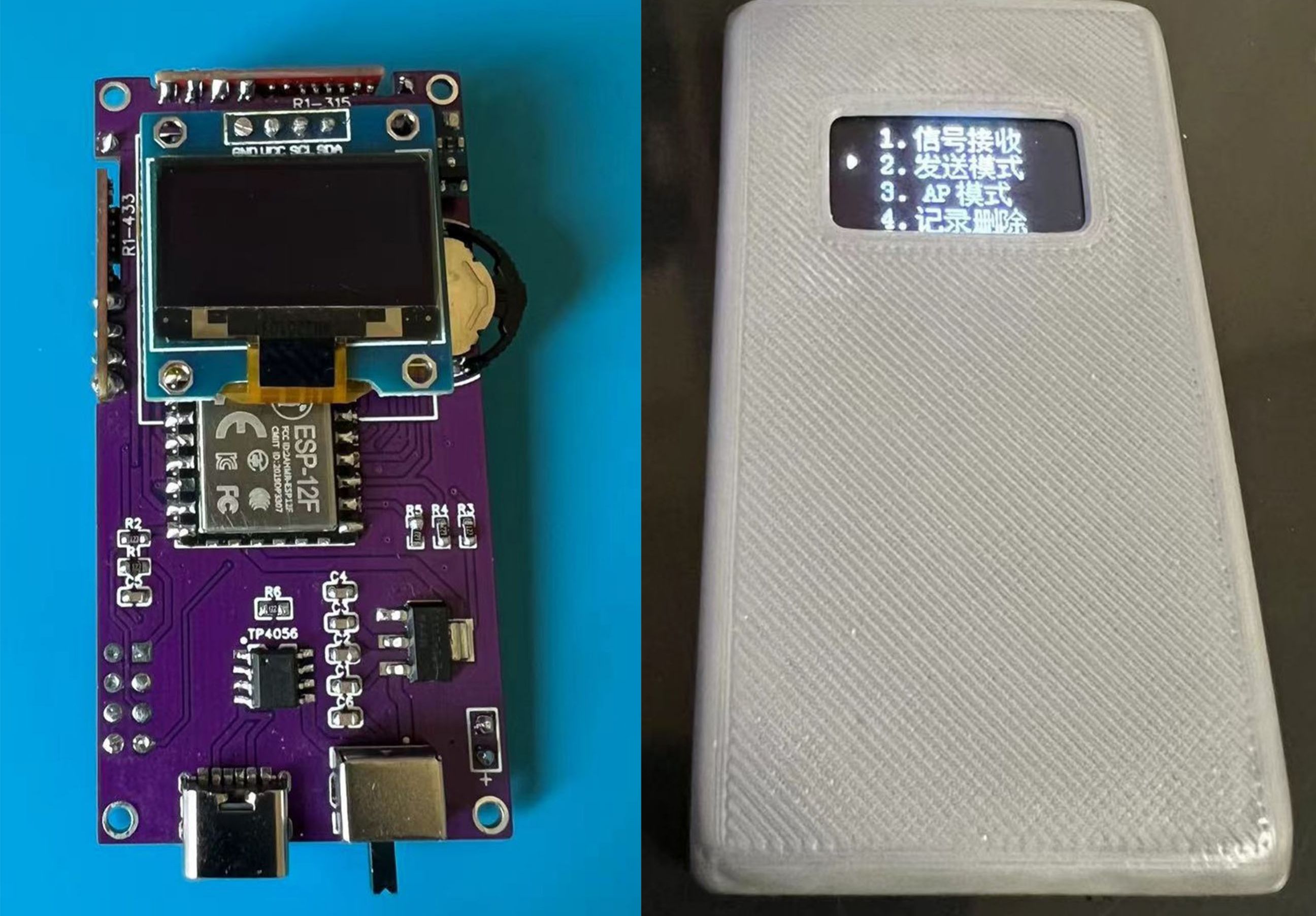

1. This project uses ESP-12F as the main control, Hummingbird Far-R1 and Far-T2L as the radio frequency signal receiving and transmitting modules, and a 4-pin 0.96-inch OLED module as the display system. Because most of them use off-the-shelf modules, the PCB circuit board circuit is very simple and almost only provides the peripheral circuits and battery charge and discharge management of the ESP-12F.
2. This radio frequency manager can copy almost all 433/315 frequency fixed code remote controls on the market.

1. The design was originally designed to simplify the circuit and reduce costs. This version V1 .2 There is no U-port programming chip and circuit designed, and a programmer is required for programming. The latest V1.3 version is designed for direct U-port burning. However, since the proofing board has not yet arrived, it is not possible to verify whether there are any errors. We will release direct U-port burning after the new board arrives and is verified to have no problems. recorded version.
2. The order of the programming ports on the PCB is according to the order of the ESP-01 dedicated programmer. You can solder the pin headers and insert them into the programmer. Remove the pin headers after programming. You can also use Lichuang. An open source project for burning clips (https://oshwhub.com/zhqsoft/shao-lu-jia-zi-pcb) modified the probe arrangement to create a dedicated burning clip. I changed it myself and will post it here after the items I bought arrive and are verified to be normal. 3. The remote R1 module is installed vertically. When soldering, you can first solder a single-core copper wire on the corresponding port of the PCB board (just peel the network cable), solder the back (cut it flat after soldering), stick out 2-3cm from the front, and then put The R1 pad is inserted into the corresponding copper wire, positioned and soldered, and finally the excess copper wire is trimmed off. 4. The remote T2L module can be directly attached to the board and soldered, or it can be supported and soldered with pin headers. 5. The PCB board size is 36*70, and both 0.96-inch and 1.3-inch 4-Pin OLED modules can be placed. However, you must pay attention to whether the order of the 4-pin screen on the board is consistent with that of the OLED module. Generally, the difference is the order of VCC and GND. , if it does not correspond to your OLED module, use an editor to open the pcb file, hide the copper layer, modify the logos and lines of VCC and GND at the screen connection on the board, then re-lay the copper and save it.
6. The designed shell size is 76*42*20. The shell 3D printing file is currently only drawn to fit the 0.96 screen. If you need 1.3, you can leave a message and wait for me to draw it and upload it when I have time.
7. Four M2*3*3.2 injection molded copper knurled embedded nuts need to be plugged into the reserved holes at the four corners of the front panel of the housing. Before plugging, you can drip glue into the reserved holes on the panel to connect the back cover and the front case. Requires 4 M2*10 flat head screws. There are many pre-embedded copper nuts and screws on a certain store for just over 1 yuan each with free shipping, and with the daily sign-in red envelope, 20 pieces with free shipping only cost a few cents.
8. If you use the case I provided, the PCB needs to be printed with a thickness of 1.2mm. The maximum battery size available is 603040. The capacity is generally 800mAh. Batteries no larger than this size can be put into the case.
