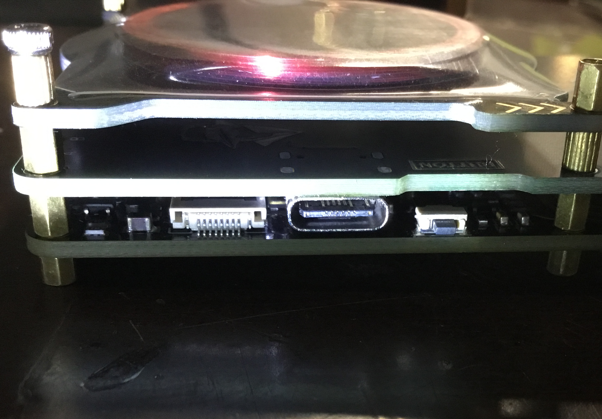

TypeC mid-layer board designed for LB’s modified version of ProxMark3
It is still in the process of improvement...
Known issues: There may be dual interfaces with different voltages causing board burnout. Please make sure not to connect two power supply devices at the same time for a long time.
This problem can be fixed using a diode
