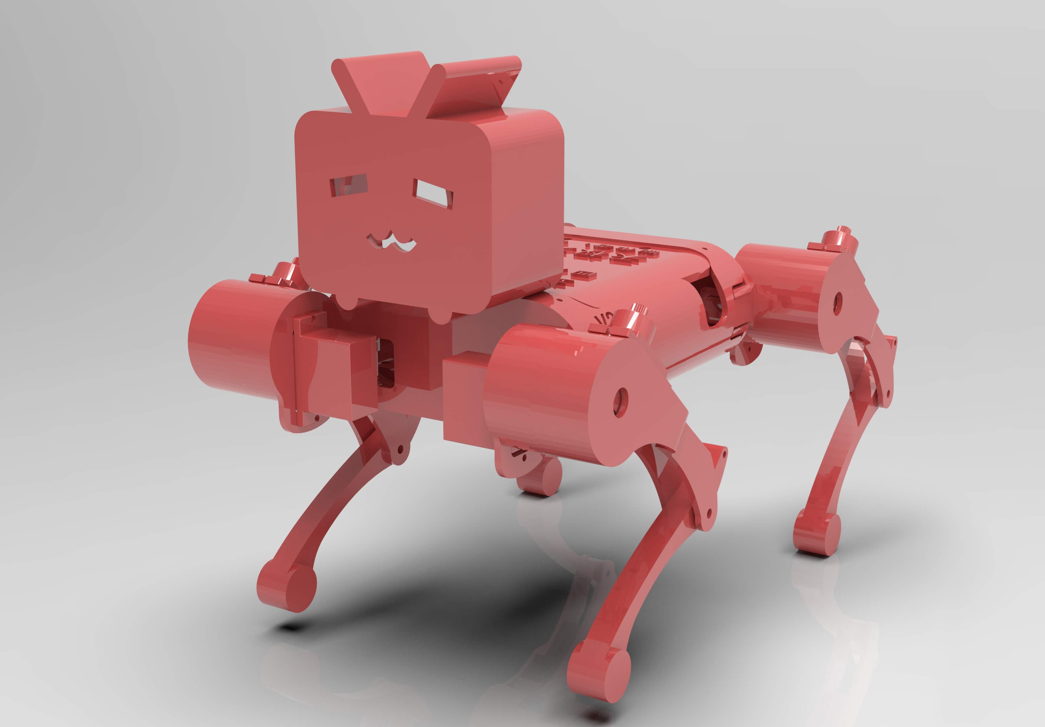

Project introduction: Design a quadruped robot, which looks like the following

Project Analysis:
1. Structural part
It is made with reference to the structure of Deng Ge's quadruped robot. The attachment is the latest version of 3D drawings, which can be directly prototyped and produced. The production price is about 200 yuan. Click here for the specific open source link: Deng Ge open source quadruped robot project 3D printing cost.png
2. Circuit part
1. Based on Hongmeng Hi3861 main control, it supports Hongmeng system development. Purchase link
2. The 8-channel servos are managed by the driver chip PCA9685PW. This chip can control up to 16 servos. Use IIC interface to connect with microcontroller.
3. The MPU6050 module reads the angular velocity and gyroscope data to identify the current status of the dog, thereby better controlling the dog's walking.
3. Software part
1. Use Hongmeng development platform for development, the development environment is ubuntu20 Linux environment compilation, and the windows platform serial port burning program

Issue not resolved
1. Circuit board design V2.0 version. The current version can only be powered by data lines because the current is too large. The 18650 battery cannot carry 8 servos, and the instantaneous current is about 2A.
It was resolved on July 22. The power supply part was replaced and powered by model aircraft battery.
