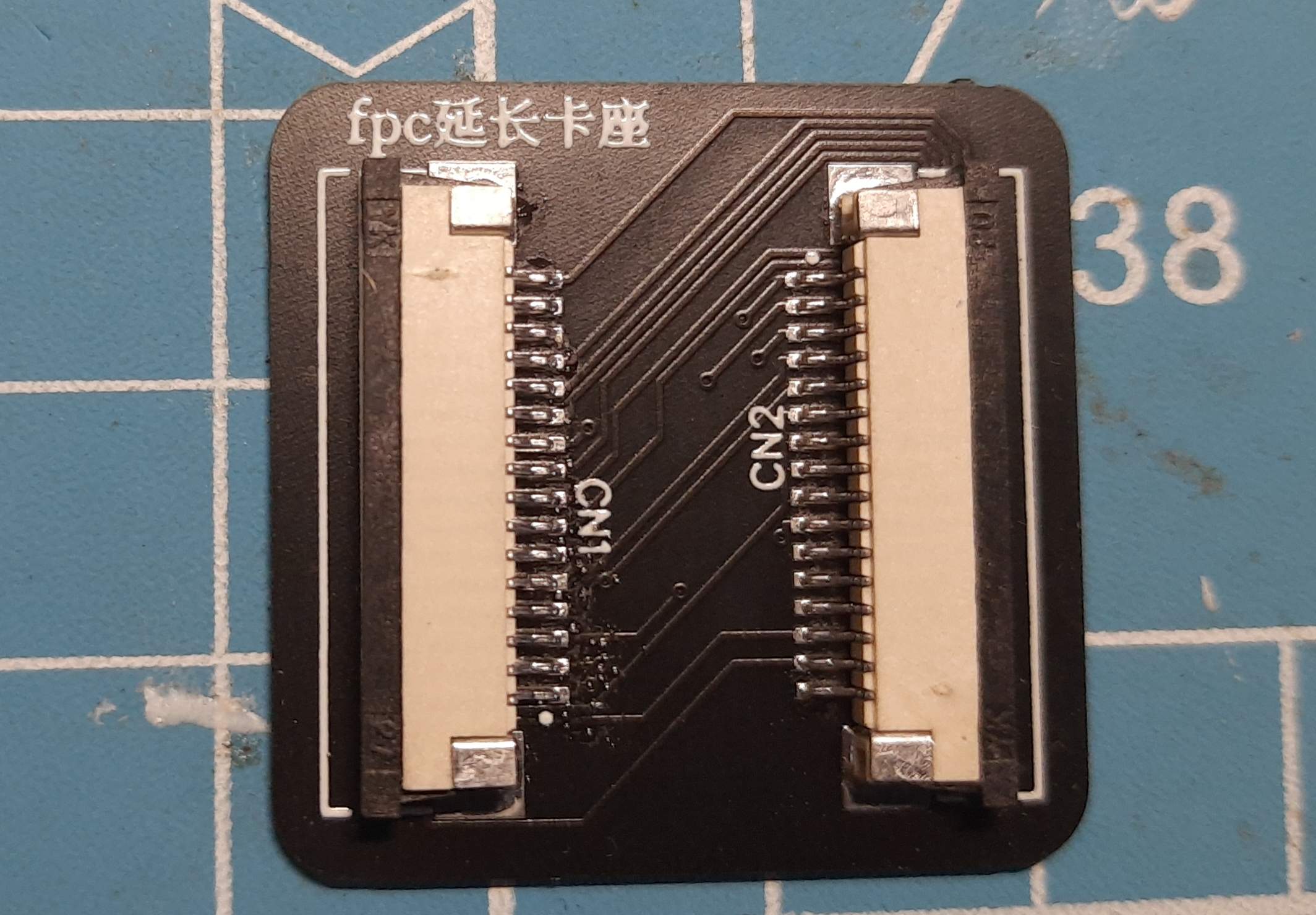

It has been verified that the board can be built directly. The principle is very simple. It is just an extension board. In fact, a certain store also sells extension boards, but they are all in the same direction. However, the camera cable of the Raspberry Pi is in the opposite direction, so I drew it anyway. piece
Pay attention when using! ! ! The Raspberry Pi's cable is 15p, but the 15p seat is difficult to buy, so I use the 16p cable. When plugging in the cable CN1, it is facing CN1, and there is an empty leg on the right side. When plugging in the cable CN2 , facing CN2, just leave one foot empty on the right side, remember not to insert it wrongly! ! !
16p seat creation link: https://item.szlcsc.com/348433.html
