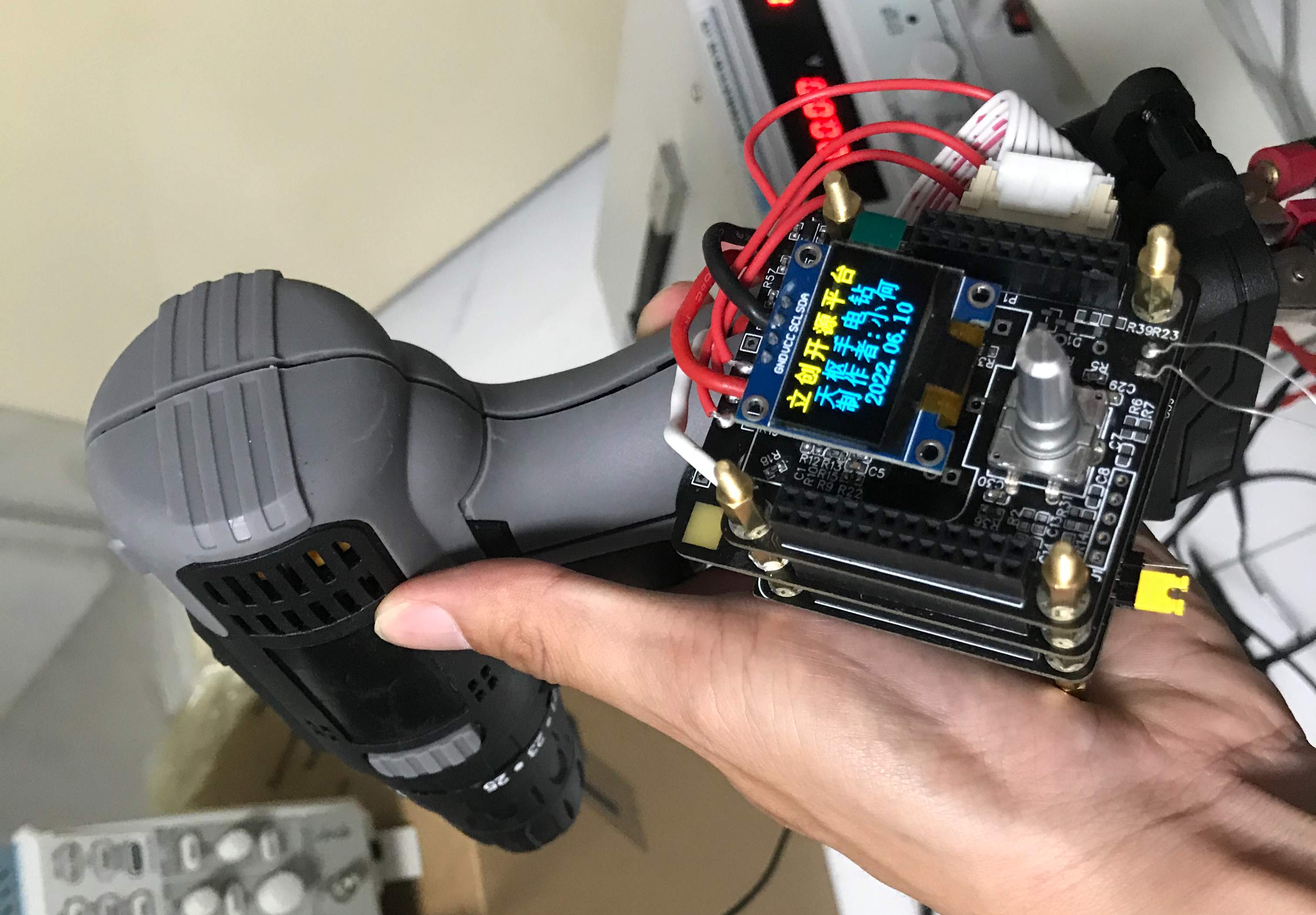

First of all, thank you for the activity launched by Lichuang EDA. The main control MCU of this project uses CW32F030C8T6
The circuit board is designed in 48X48 (mm) size, which is compact and convenient. It uses 2.54 pins to connect each group of circuit boards. In theory, circuit boards can be stacked infinitely to achieve various functions.

The project has been merged and divided into three sets of circuit boards for assembly and use. The completed assembly picture is as follows
Project 1------" Main Control MCU Project "
Project 2------" Brushless Motor Circuit "
Project 3------" Display function board "

In order to test the performance of the CW32 microcontroller and facilitate the implementation of other functions, the circuit board is specially divided into three parts: 1. Power board 2. Control board 3. Motor control board
The circuit board is installed with pin headers and female headers for easy replacement or other uses.

1. Microcontroller control board
The microcontroller control board leads out all the pins of the CW32F030C8T6 chip, and leads out the pins on both sides.

The design size of the main control board and display board is 48X48MM, so that the two circuit boards can be assembled with a spacing of 1.6MM. Then form a 100X100 circuit board, and break it open directly with your hands after receiving it. In this way, we get 2 main control boards and 2 display boards, which can be directly used for circuit proofing on the Jialichuang platform ====== Thanks to Jialichuang
Among them, the brushless motor control board, I tried 48X48 and it really couldn't fit. It may be a problem with component selection. The MOS package is reduced and optimizing the circuit routing should be able to do it.
Software description
1. The software needs to be improved, and there are still problems. I have burned out my two mos tubes and the full-bridge driver chip. I see the chip smoking...,,,,,,,,,,,,,,
