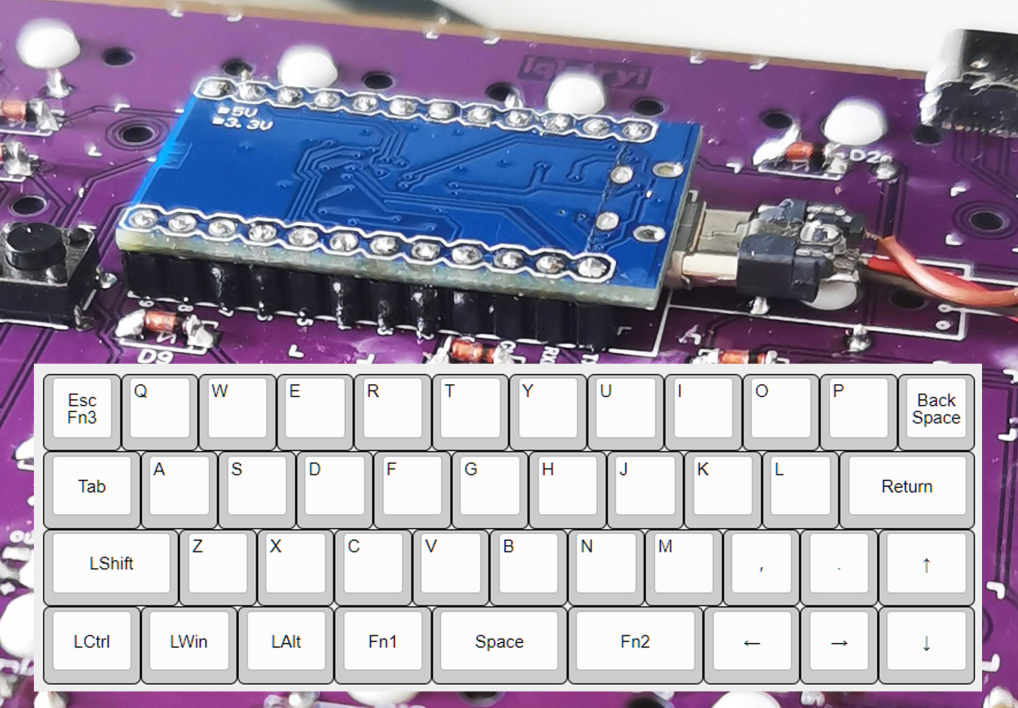

Some time ago, I made a simplest programmable in-line keyboard with RGB for personal use, and it was also loved by many friends. A friend was not used to in-line keyboards and asked if he could make a small keyboard with an ordinary arrangement, so this keyboard was born.
The simplest programmable in-line keyboard with RGB, suitable for beginners

There is no need to use a satellite axis, the positioning board is used as needed, and pro micro is still used as the main control, QMK firmware.
The round socket is welded on the motherboard, the welding hole is enlarged, and the round socket is attached to the motherboard. The PRO MICRO module component faces the motherboard. The module does not use pins, but directly solders the component feet as pins to minimize the height.
The module is a micro socket, and wires are used to connect the module to the type c socket of the motherboard; the reset uses a micro switch to open a small hole on the base plate to facilitate burning firmware.

The Capslock light is installed in the middle so that it is not easily blocked by your hands when using the keypad.
The bottom row is equipped with RGB lights, and different colors correspond to different layers.
Level 0: letters + function keys, Fn1 enters the numeric keyboard and punctuation mark area, Fn2 enters the F functional area and punctuation mark layer. Tap Fn3, type Esc, and long press to enter the software shortcut key and media key layer.
In order to facilitate comma and period as page turning in the Chinese input method, the independent direction keys have been slightly changed.
When typing with both hands on the keyboard, press Fn1 and Fn2 directly down with both thumbs to switch between Chinese and English, and Fn1 and space to switch between uppercase and lowercase keys.
Press and hold Fn2, the direction keys become pageup, pagedown, home, end, and the backspace key becomes the Del key, which is convenient and fast.
Level 1: On the left is a complete numeric keypad and arithmetic symbols, which is convenient for the left hand to input numbers with one hand. On the right are some punctuation marks. All punctuation marks are arranged according to personal habits and easy to remember, such as? It is the F position where Fa asks the question, # is at the J position of the pound sign... +-×/= takes into account the use of the numeric keyboard.
Level 2: Some punctuation marks are on the left, the F function key area is on the right, and the arrow keys in the lower right corner change to pageup, pagedown, home, and end.
Layer 3: Software shortcut keys and media keys. The volume, forward and backward of the media playback keys are consistent with the operation habits of the direction keys. Fn3+letter is equivalent to Ctrl+Alt+Shift+letter and can be set as a software shortcut key. For example, Fn3+C runs Chrome, Fn3+Q runs QQ, Fn3+W runs WeChat, Fn3+M runs music music software, and Fn3+V runs video video software......
