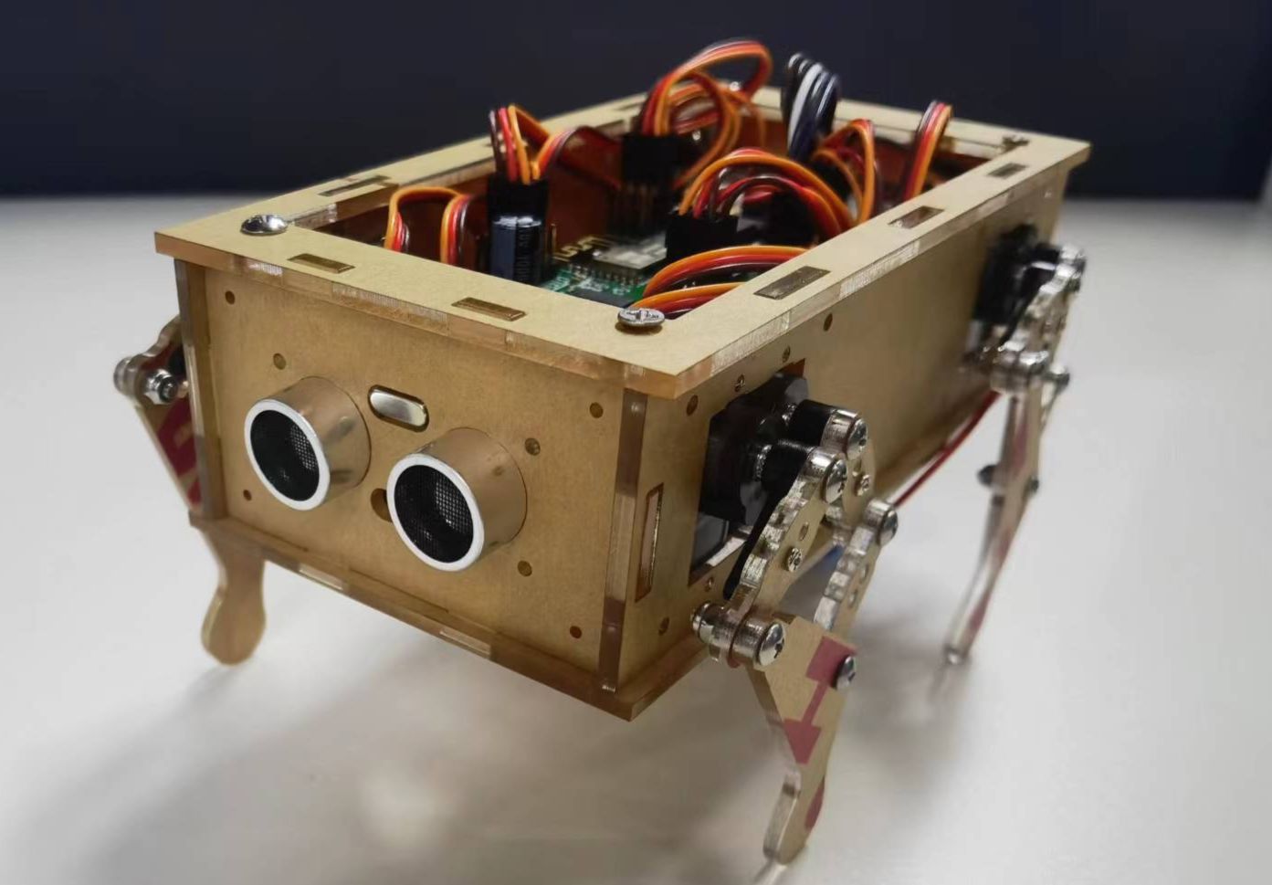

Introduction: Robot dog using OpenHarmony system
Product introduction: It is developed based on the OpenHarmony open source Hongmeng system. The chip used is hi3861, which supports 16-channel servo control, GPIO, ADC, PWM and other operations.
Functions such as forward, backward, left turn, right turn, lie down and other functions of the mechanical dog have been implemented. Reinforcement learning will be supported in the future. (requires expansion of mpu6050)
Application scenarios: Can control robot dogs, small spiders, servos, gimbals, robotic arms and other products, supporting up to 16 channels of servos
Chip solution: multi-channel steering gear control board based on HiSilicon Hi3861 chip and PCA9685
Product core parameters:
Working voltage: 7.4V~20V with overheating and overcurrent protection
Hardware interface: gpio, ADC, PWM
Double-layer board design single-sided layout
The total material cost of the complete set: 165~300 yuan
pcb: Jialichuang free sample
components: about 50 yuan, pca9685 is currently out of stock in Lichuang Mall
8 servos (7.2 yuan each for a certain treasure) + PCA9685 (more than 10 yuan for a certain treasure): 70 yuan
Dog body structure: Acrylic cutting version (about 20 yuan)
3D monkey 3D printing version (about 100 yuan)
Others: M2.5 screws, anti-slip nuts and some self-tapping screws, about 10 yuan. 7.4V lithium battery: 15 yuan.
(The steering gear screws are all provided, 12 M2.5*10 screws, 12 M2.5 anti-slip nuts, 4 40mm double-pass posts, 8 M3*10 screws, 8 M2 .5*7 screws)
