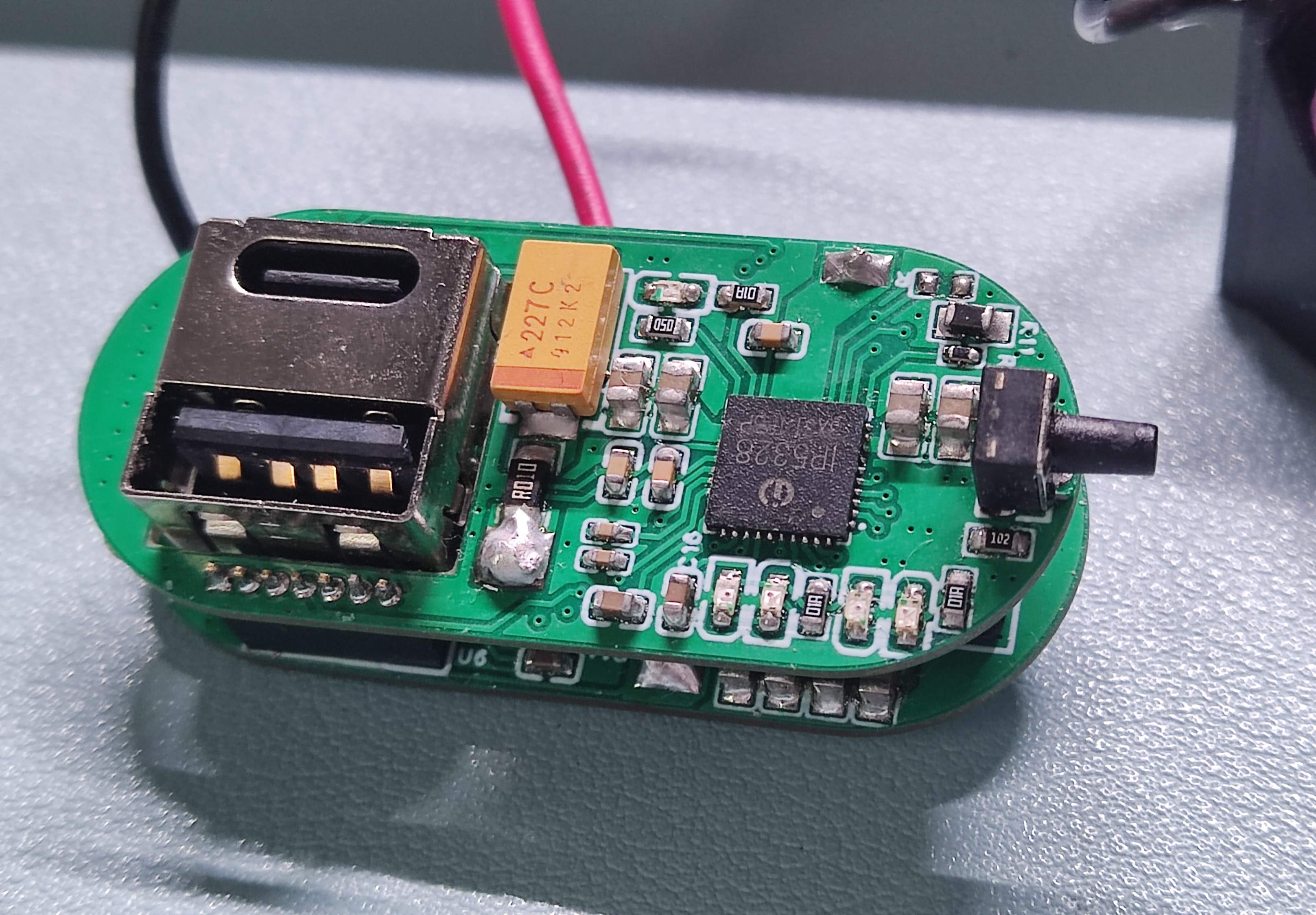

IP5328P power bank [verified]
IP5328P power bank, double-layer board structure, compact size, two-section 18650 driver, supports QC PD FCP SCP and other protocols.
There is a designed shell, but there is no printing test. For dimensions, please refer to the 3D diagram.
The lithium protection part is very hot, so you can directly connect it to GND without soldering
. Video:
