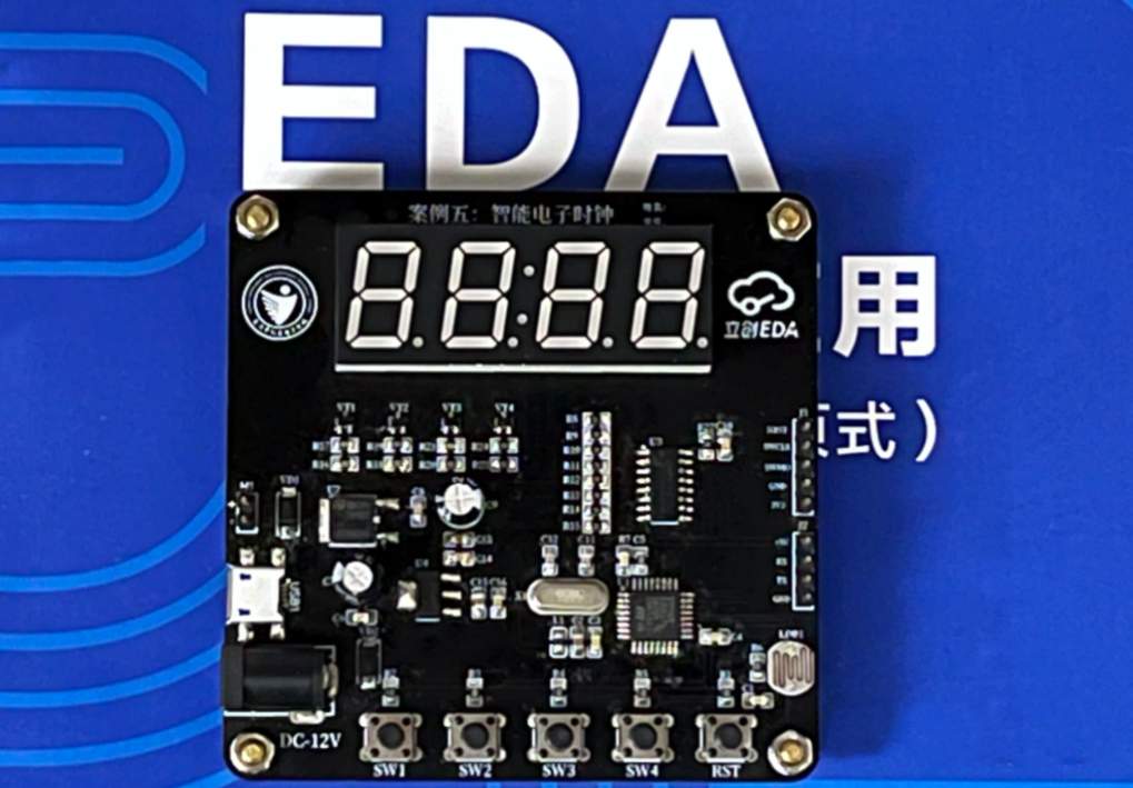

1 Project Introduction
    The electronic clock of this project is designed with STM32F030K6T6TR microcontroller. By realizing light intensity sensing, the brightness of the digital tube is automatically adjusted to realize the time display of the electronic clock.
2 Overall Scheme
    The overall scheme system block diagram is shown in Figure 2-1. The electronic clock based on STM32F030K6T6TR consists of a power supply circuit, an STM32F030K6T6TR microcontroller, a photosensitive circuit, a digital tube drive display circuit, and a button setting circuit.
3 Circuit Principle
    The power supply part adopts a DC power supply connection socket and a Micro USB interface sink board design, and a 2-pin header is reserved for external power supply.
    By programming the STM32F030K6T6TR microcontroller, the MG-52B photoresistor realizes light intensity sensing to automatically adjust the brightness of the digital tube, and uses a 74HC595 shift register to drive the display digital tube to realize the display of time, and customizes the function buttons to adjust and set the electronic clock.
    The program download interface reserves a 2.54mm pitch pin header for the SWD interface 1x5Pin and a 2.54mm pitch pin header for the UART interface 1×4Pin. Use 4 M3 copper column screws to fix the board.

5 Soldering assembly
Figure 5-2 Actual picture of smart electronic clock based on STM32F030K6T6TR
