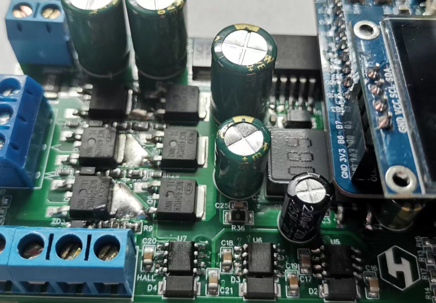

The hardware part refers to the Youite open source solution with only slight modifications; the software part is an open source solution. I am a software novice and am currently learning. Finally, I am very grateful to Jialichuang and Unitech for their strong support. I hope that domestic EDA and domestic chips will get better and better.
Physical map
Function
  • 1. Support sentient and non-sensory BLDC
  • 2. Support potentiometer speed adjustment
  • 3. OLED display
  • 4. Serial port control (to be added later)
  • 1. The power board and main control core board are stacked
  • 2. The board frame is moderate 81.8 x
    50.5mm
  • 3. LM2596 wide input dcdc
  • 4. CJ7805 linear voltage regulator
  • 5. TVS anti-surge design
working environment
Voltage 16-27V, current 30A
