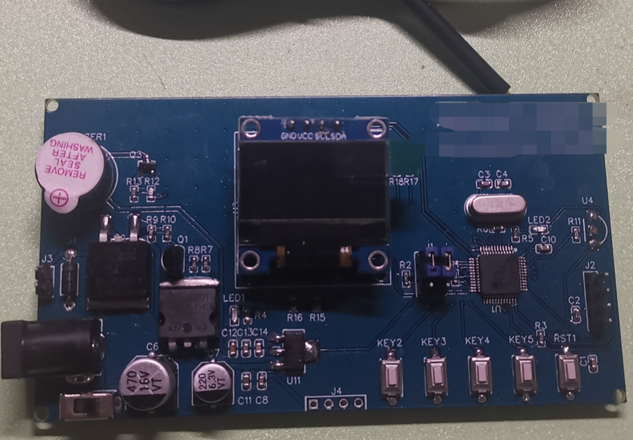

5. PCB design instructions
PCB size is 100mm*55mm.
The TFT screen supporting copper pillars are M2*14mm copper pillars.
The diameter of the through holes at the four corners of the board is M2.
7805 is in SOT252 package, and IRF9530 and 7805 are both SMD ones. I hope you don’t accidentally buy direct plug-in ones like me...
For DS18B20, you can choose the one with wires or the one with direct plug-in. Just be careful not to solder it backwards.
There is something wrong with the packaging and shape of the OLED screen. It may not match the copper pillar holes of the OLED screen you bought. You can adjust it yourself if necessary.

7. Physical display instructions

You need to connect the lines of the water pump and the solenoid valve together, and then connect them to the J3 port. The solenoid valve is not divided into positive and negative, but the water pump is divided into positive and negative, so do not connect them reversely (although it will not be damaged if they are connected reversely, but the water supply Blowing bubbles in it is of no use).
