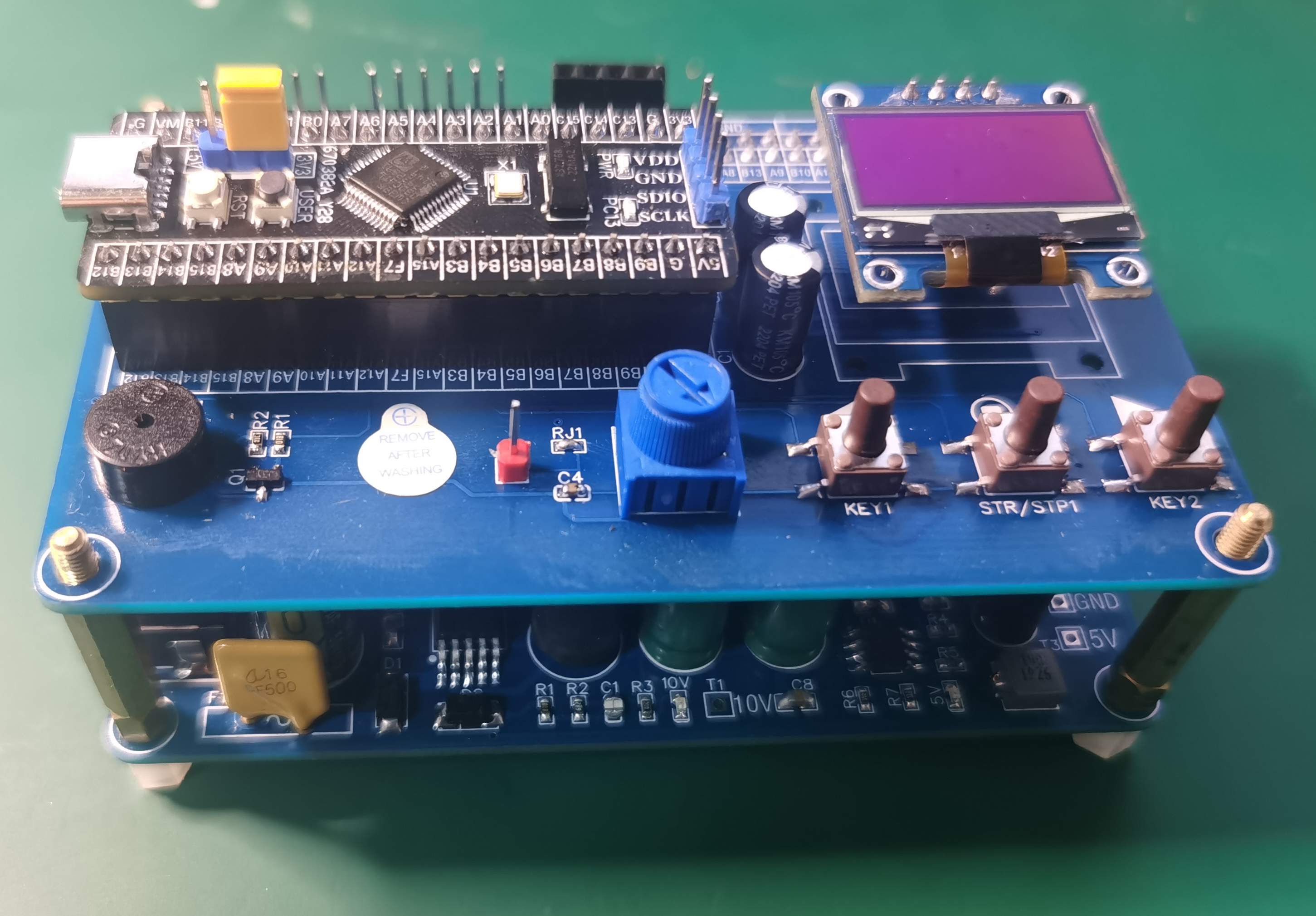

2. Circuit board welding
        During the Dragon Boat Festival holiday, components arrived one after another. Welding, testing, power-on short circuit, troubleshooting, and troubleshooting. There was no hot air blower on hand, and the MOS tube welding could not be solved. I found a hot air blower in the past two days to get it done. Here are a few physical pictures. As shown below. (2022-06-07)
1. Core board + matching bottom board:IMG_20220608_002127.jpg
2. Motor drive board
3. Assembly view:
Notes on welding and assembly:
1. The base plate is welded to the pin header, and the motor drive board needs to use an extended pin header. The base plate and the motor drive board are directly connected through the pin header;
2. The welding of 5x6 Mos tube needs to prevent short circuit;
3. Before assembling the base and motor drive board, it is recommended to test whether the functions are normal separately and confirm that there are no short circuits and other problems before assembling them together;
4. The pin headers connecting the drive board and the bottom board need to be extended pin headers. The specific length depends on the highest component selection of the drive board and ensures that the length can meet the reliable contact with the upper female socket .​

        For my circuit board, in addition to a soldering iron, it is recommended to use a hot hair dryer for soldering. If you are used to using flux, you should confirm whether there is a short circuit problem after soldering LQFP48 and 5x6 MOS. I use a blade soldering iron for microcontrollers. The welding is completed in one pass, just rinse it with washing water. If you want to ask how to weld it well, I can only say that it took a lot of practice and it was all achieved through various weldings when F103C8T6 was made in 4 pieces;
        MOS was soldered at home with a soldering iron and flux added. It turned out that there was too much flux. I was overconfident and careless. I directly powered on 12V and tested the result that it was short-circuited. Then I found a place to blow it off with a hot hair dryer and cleaned it to help. After re-soldering the flux, I still found that two MOSs were damaged, which was very frustrating.
3.1.3 Circuit test:
        It is recommended to check the core boards 1 and 2 and the supporting backplane as one part, and the motor driver board as another part. It is best to have an adjustable power supply. If there is not, use a multimeter to confirm whether the power supply part is short-circuited and then power on to test the voltage of each point. Is it normal?
1. Core board and supporting base board
       It does not have many special functions. Simply measure the resistance between GND and 3.3V and 5V to ensure there is no short circuit. When the microcontroller is soldered close to the naked eye, you can usually see whether there is any empty solder, but there is a short circuit between the pins. It is difficult to check. It is recommended that after welding, brush it with washing water and blow dry it with hot air. If it doesn't work, you can also blow it dry for a while. Once the program is programmed and the OLED can display it, and the PWM duty cycle of the rotary potentiometer can change, there will generally be no problem.
        Warm Tips: The actual capacitance of the two 100uF capacitors on the matching base plate has a lot of redundancy. It takes some time to charge once it is powered on. It also takes time for the charge pump of OLDE to start up. Once it is powered on, the microcontroller IIC OLED has written the corresponding configuration, but the display will be due to the power lag not being set properly. If the open source code used directly does not display, you can try pressing the reset button of the core board, press and release for a few seconds, and sometimes it will be normal. Of course, you can also wait 200ms before initializing OLED in the code (resulting from the pitfalls that have been stepped on over the years).
        It is recommended to test this board in two stages. The first stage is to test the voltage conversion circuit. The power conversion part is soldered first. The R2 on the schematic diagram is 7.2K . It is more expensive on Lichuang Mall. In actual use, I chose a cheaper one. The 6.8K resistor can conduct normally with a test voltage of 9.65V; input a voltage of 12V to 30V, measure and confirm that the buck circuit is OK before welding other components.
        In the second stage, weld other components. First, measure and confirm that GND and VIN, 5V, and 3.3V are not short-circuited. Then power on and test. Since Nmos is used in the circuit, high voltage conduction, the input port of the driver chip EG2133 automatically Bring pull-down resistors, so you can individually test whether the 6 Mos tubes are working properly. After powering on, the G poles of the 6 Mos tubes should be 0V, the Mos tubes are in the off state, and the D pole voltage of the 3 upper tubes is equal to VIN, 3 The S pole voltage of the lower tube is equal to GND.   Use a DuPont line to short-circuit 5V and MCU_UH, MCU_VH, and MCU_WH respectively. Check whether the MOS tube can conduct normally. Then use this DuPont line to short-circuit MCU_UL, MCU_VL, and MCU_WL to GND respectively. , test whether the MOS tube is in positive conduction. While testing the function of the MOS tube, it also verifies the function of EG2133.
