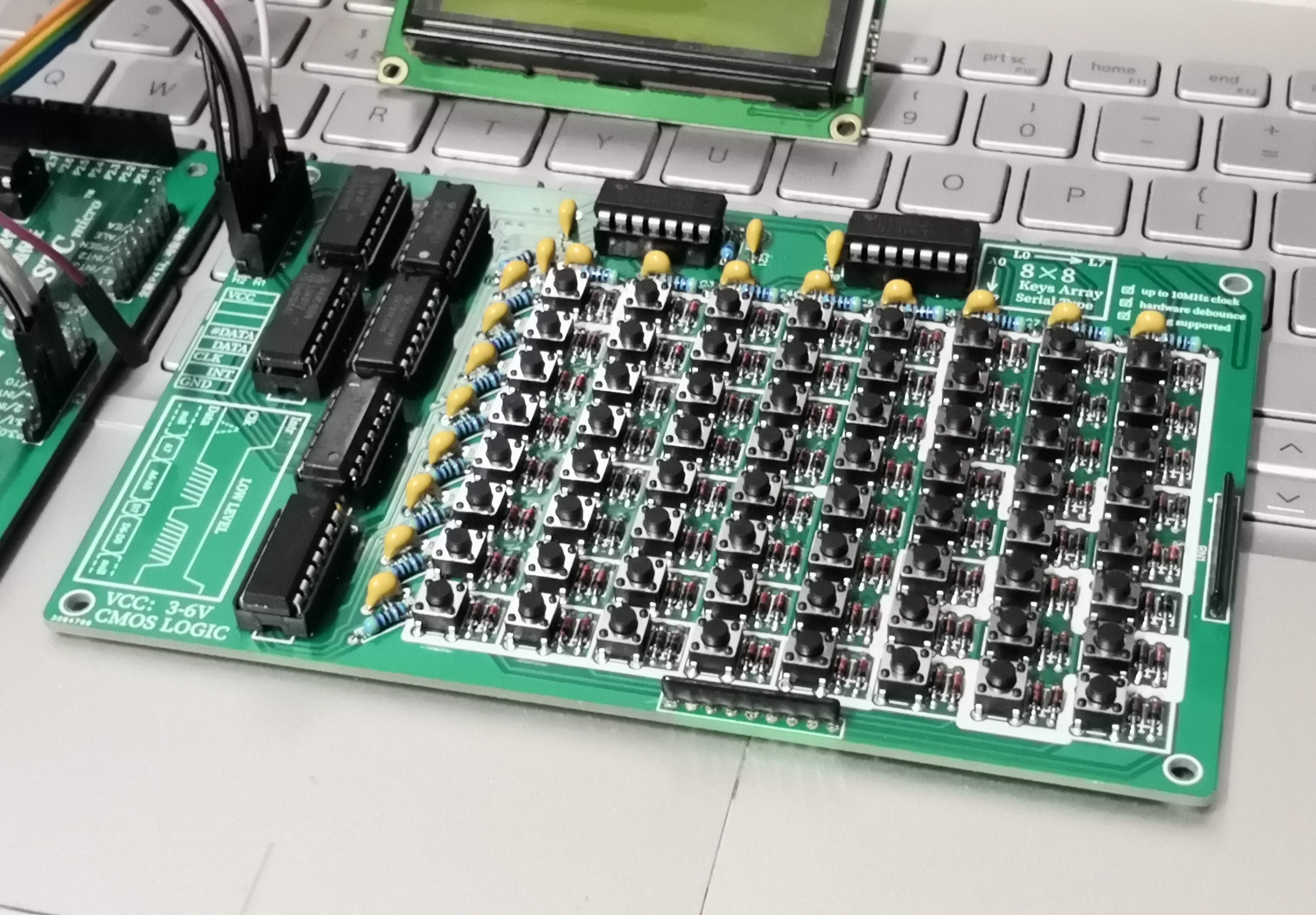

Features of this work:
Supports a maximum I/O port flip speed of 10MHz;
Large number of keys, 64 keys, can be expanded;
Hardware debouncing, no software delay required;
Interrupt mode outputs key press signal to save MCU resources.
This piece has 5 pins:
1.VCC (supports 3.3V-6V)
2.GND (public ground)
3.INT: Interrupt output port. When any button is pressed, it outputs a low level. After the button is released, it returns to high level.
4.CLK: Clock input port, the rising edge is valid; when the button is pressed, the MCU gets the interrupt trigger signal, and the microcontroller outputs a rising edge to CLK, making the keyboard in a readable state. At the same time, the DATA port of the keyboard spits out a bit, and then the microcontroller Then output 15 rising edges to CLK, and the keyboard outputs a total of 16 bits, which is two unsigned char;
5.DATA: Keyboard serial data output pin. In the reading state, a bit is output after each rising edge of the clock.
Fundamental:
The button, resistor, capacitor and 74HC14 form a button debounce circuit. After the button is pressed, a jitter-free signal is output;
74HC165 is responsible for temporarily registering the status of the button (parallel signal) and spitting it out in serial mode on the rising edge of the clock;
74HC30 is responsible for detecting whether a button is pressed. When pressed, the 74HC30 output terminal flips;
