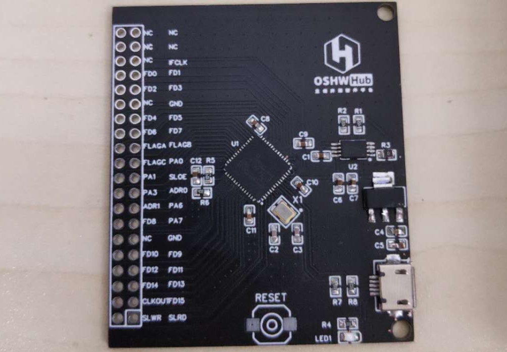

This project is used to verify the solution verification board design of Lichuang Mall USB chip CY7C68013A-56LTXI.
This project is a sample project for the Solicitation Order for Lichuang EDA Open Source Hardware Platform Solution Verification Module
This version is compatible with CY7C68013A-56LTXC
CY7C68013 Introduction
cy7c68013 is a microprocessor with integrated USB2.0
Embedded enhanced 8051 operating at 48MHz
This design leads to all pins of CY7C68013A to facilitate verification and testing.
Onboard 24LC64 (EEPROM) can save the program during power failure
Use MicroUSB interface for power supply and communication
Note that during DRC inspection, change the hole to an inner diameter of 0.3mm, an outer diameter of 0.4mm, a spacing of 0.1, and a line width of 0.2
1. Proofing
I specifically chose black. LC’s free solder mask color fee is really good. After waiting for three days, I got the board.
2. Welding
I used the company's solder paste and air gun, and it was very comfortable to use the air gun to solder QFN.
