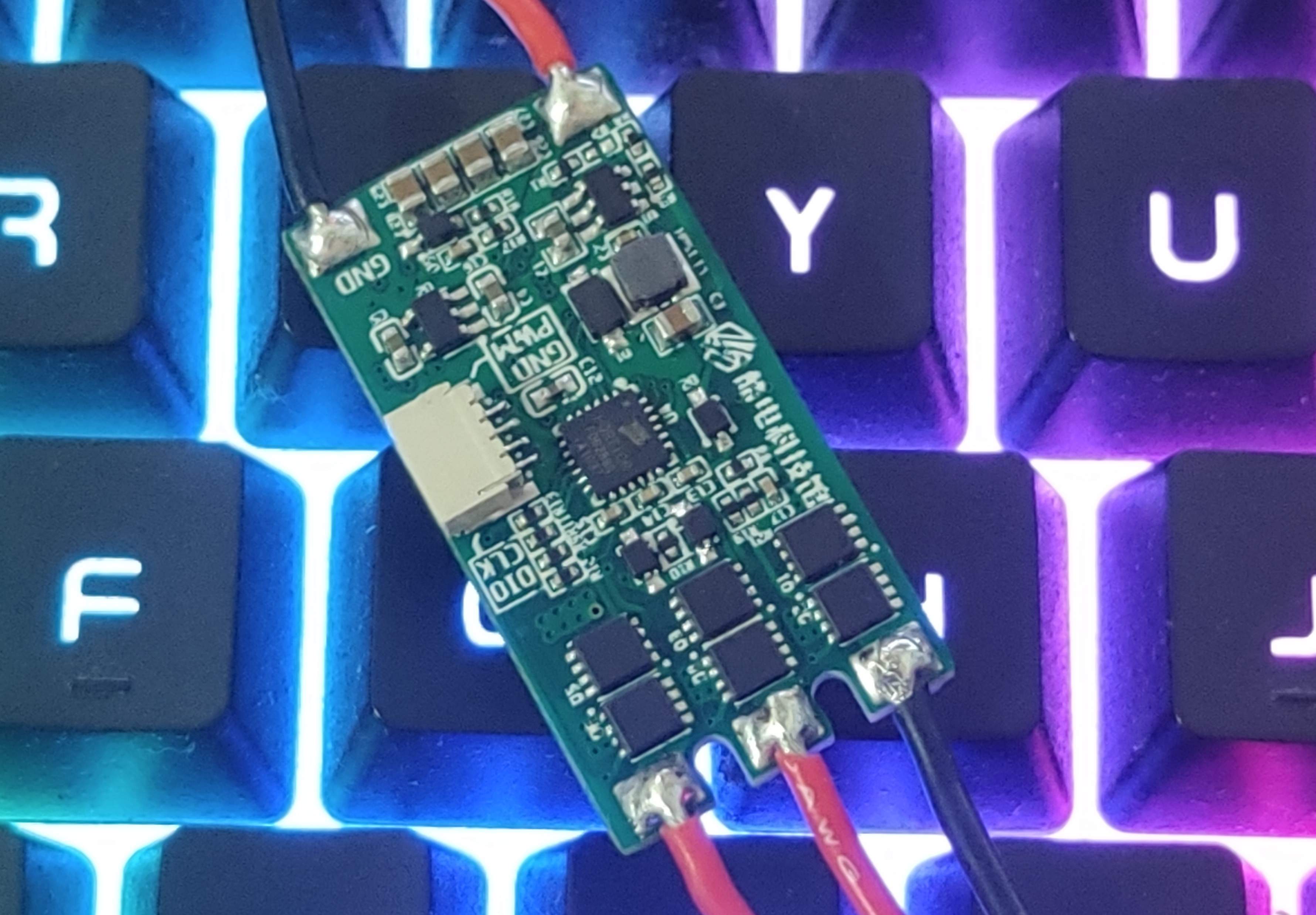

Hardware: Inductive brushless motor controller based on Xinyuan CW32F030, input voltage 3S~6S, FD6288 driver, non-inductive back electromotive force (zero crossing detection: virtual neutral point comparison), phase current sampling (FOC torque control)
Software: Non-inductive speed closed-loop control and PWM input speed regulation have been implemented. Over-current protection, under-voltage protection, torque control, etc. are to be implemented.
2. Physical objects
