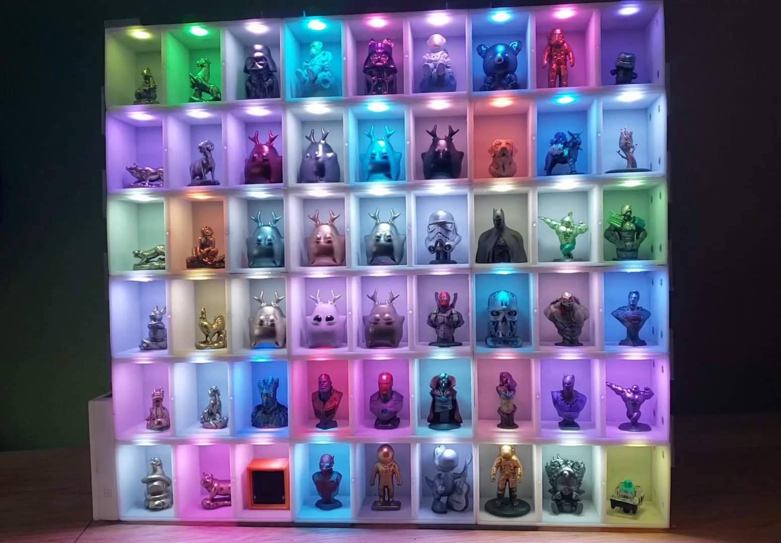

This project mainly uses the principles of LED lighting effects and dot matrix screens to make your little figurine box no longer look boring and can achieve many different effects. If you have a 3D printer and like to make figures, spray paint, or pen paint, you can consider printing according to the size requirements. The current version is only for small sizes.
Specification
  • The currently designed size is mainly used for smaller objects: 39 (height) x 29 (width) x 33 (length) mm
  • The board adopts a modular design, which can be expanded with a variety of functional modules and supports later function upgrades.
  • The smallest unit of the box is 1x3 (that is, one row and three columns), and the height and width can be infinitely expanded.
  • What we are currently making is 6x18, which means that there are 108 boxes. You can assemble a set of Water Margin characters. It should be quite shocking. The overall size is about 610x274mm.
  • Using esp8266, compatible with esp32c3
  • Can be hung on the wall or placed on the table
  • USB Type-C powered
