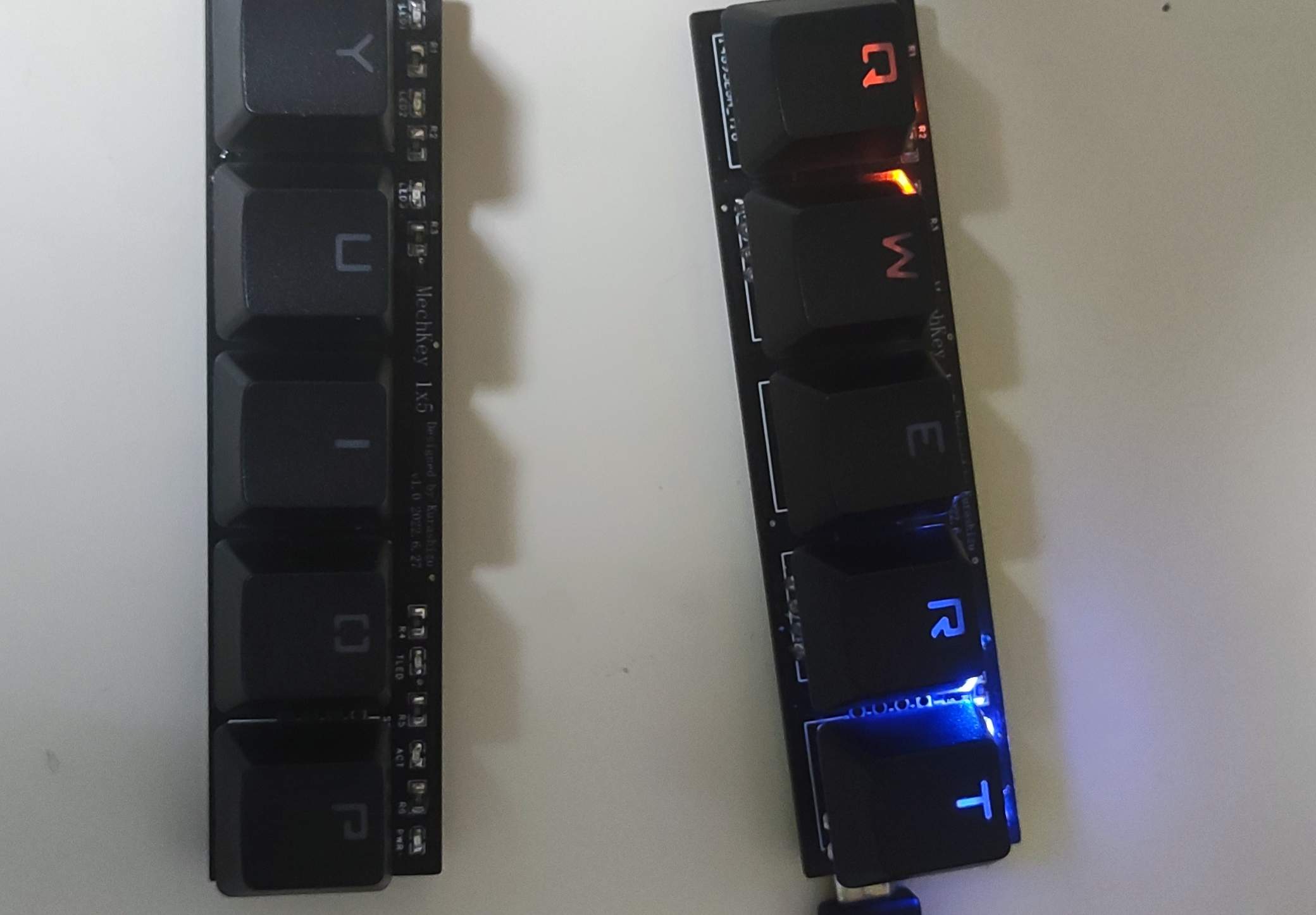

Preface
It can be used for daily office work and audio and video games. The total cost can be controlled within 10 yuan.
Currently, only the 1x5 version has been made, and the 5x5 version has not been completed due to time reasons. Therefore, the current firmware only supports the 1x5 version, and there are no BUGs after testing.

◇ Layout
As shown in the picture below, there are 5 mechanical buttons on the front of the device, which are called ABCDE from left to right (the markings on the specific keycaps may not match, for convenience, this description will always be called ABCDE). The three LEDs in the upper left corner are LED1, LED2, and LED3.
