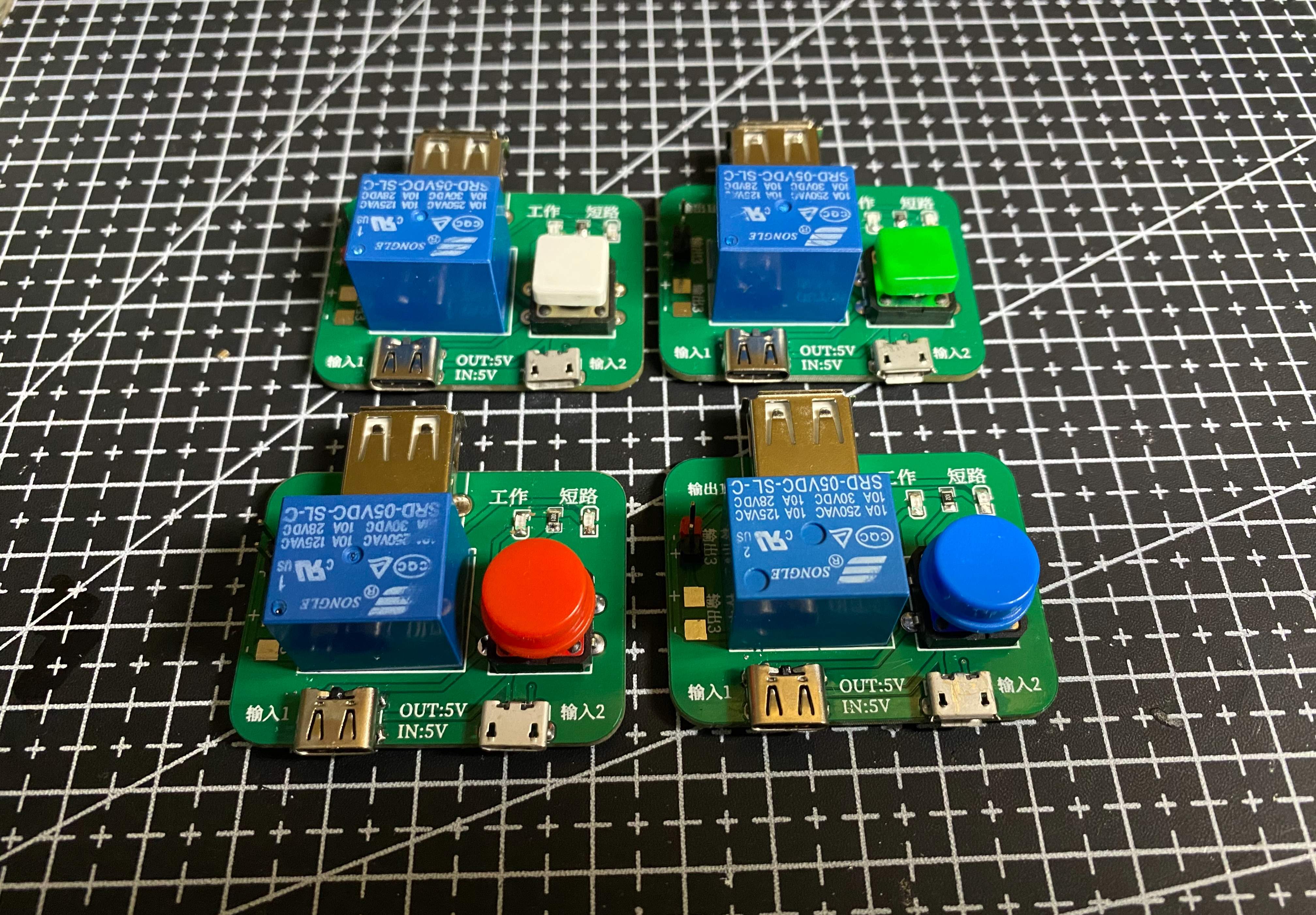

Demand scenario:
When soldering the input power and output interface of the board, sometimes the pins are too thin and I don’t know if they are connected with tin. The only way is to power on first (Boom!!)
When plugged into the computer, it will prompt
This is not computer friendly.
PCB design matters:
1. Choose 6PINS Typec and common Micro interface, two-way input, just choose one when using it.
2. There are three output options for output
1.USB female socket
2. Pin arrangement
3. Solder joints
Different output schemes can be switched according to the usage scenario!
Instructions:
1. Plug in any power supply at the input end (choose one of the two)
2. Click the reset button to energize the output.
The green indicator light appears when the load is not short-circuited.
The load short circuit status is a red indicator light.
Precautions
You can test whether the load has a short circuit, but you cannot test the overcurrent protection of the load!
Netizens who have the conditions can draw a board that can test both short circuit and overcurrent protection (add chicken legs for you!)
The principle of this project is relatively simple
I also copied the schematic drawings from the Internet. In fact, this short circuit test board is also very simple. The components used are all commonly used around me.
The design is also very clever!
You can solder manually according to the schematic below, even without a PCB!
