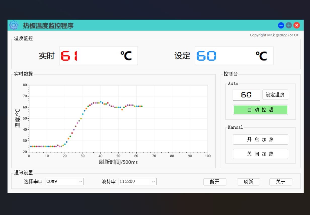

Write a few lines of patchwork program, plug in the development board, the program here is very simple, turn off the heating when the temperature is reached, and raise the temperature when it is not reached. As for why not use PiD, adjusting parameters is too annoying, and the amount of code is not small. Originally, this thing simply controlled the temperature, and a few degrees difference would have no effect;
Because I couldn't find the display module and couldn't always use the serial port assistant to control it, I took advantage of the situation and wrote a software. It was written in WinForm. The code was pieced together. There must be bugs. It is normal for it to crash or throw an exception whenever it is used. Too lazy to change, haha;
CK07QLIhyZ1I4TVxgIiEvmCUSAoH629SxiQDLuIg.pngiXZG8tW0K2RzmlpLgmvZCpwZjGmgRh3l1aKsHTIu.png
