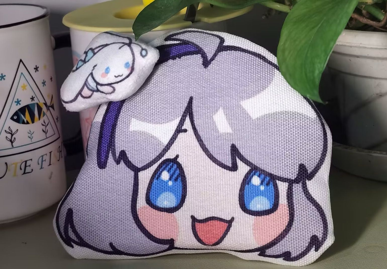

Xingtong talking dumplings can remind you to drink water regularly
# Star pupil voice dumpling
## Zero, function description
Based on the ordinary button voice dumpling, add the following functions:
+ Timed reminder to drink water
+ Double-click to tell time
+ Play the corresponding voice when the magnet approaches or moves away
If you want to change the time period for reminding to drink water, just modify the macro definition at the beginning of the program:
```c
//Time period for reminding to drink water
//The default here is to remind you to drink water at the 01st minute from 8 am to 10 pm every day
#define beginTime 8
#define endTime 22
#define Nmin 01
