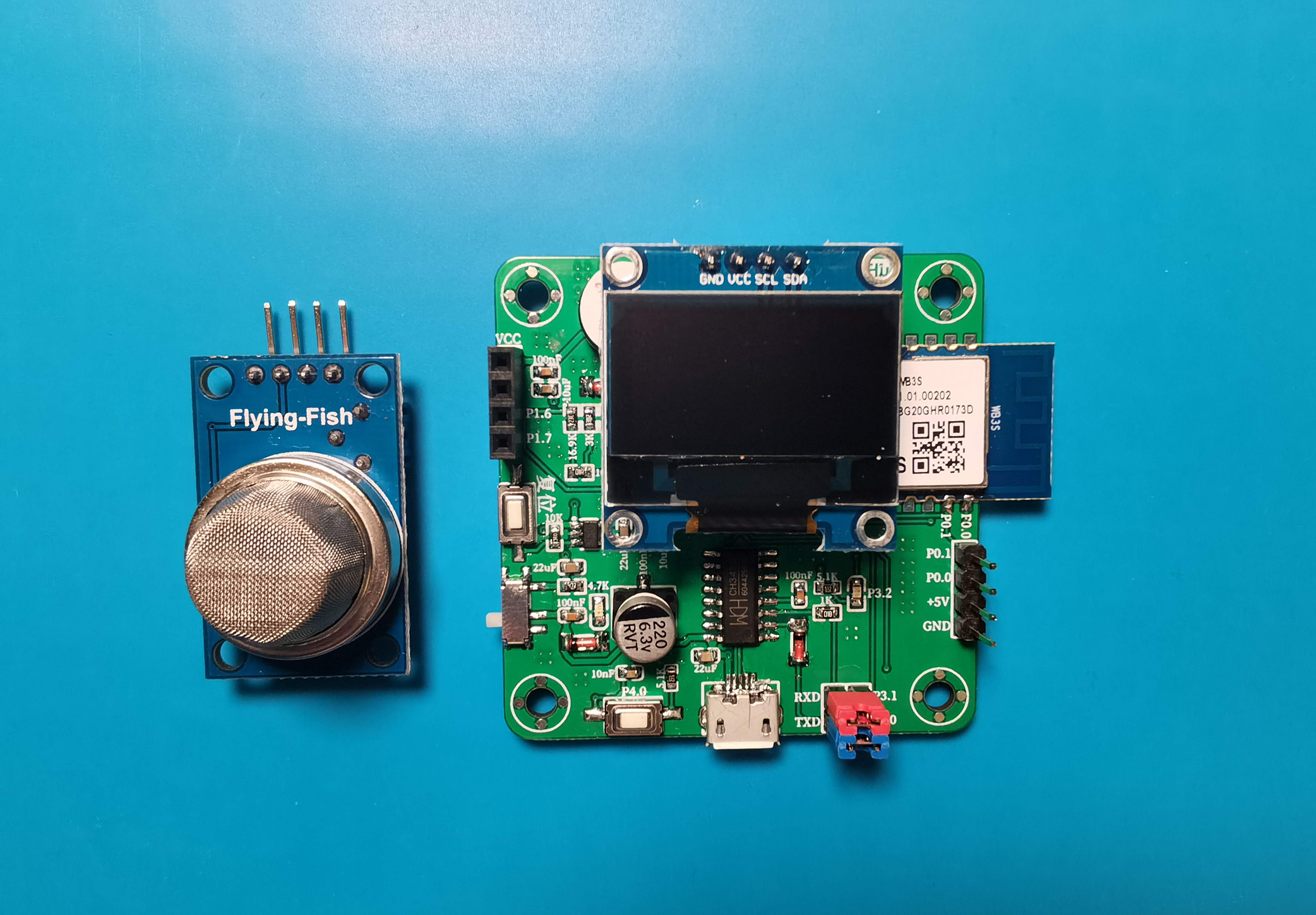

[Tuya Smart] Gas alarm device
  • This is a WR3S gas alarm device based on the Tuya module. The gas detection part uses the MQ-5 module for detection, and is equipped with a 0.96-inch OLED display to display relevant data. Since the MQ-5 module only leads to the relevant MCU pins, you can also replace other modules in the MQ series according to your own needs, and it is compatible with most 4-pin modules.
  • Functions currently implemented: Use a lighter to ignite and blow out simulated gas. When gas is detected, the buzzer sounds an alarm and is displayed on the Tuya APP. Since only one button and one LED light are designed, this button is used to switch between smart mode and AP mode, and the LED lights flash quickly and slowly respectively.
  • (Currently, the display part cannot be made, and I don’t understand the part about measuring the analog pins of the MQ series module corresponding to the gas value. There are also some data sending and receiving in the Tuya module that I don’t understand. I will improve it a little later when I have time)
