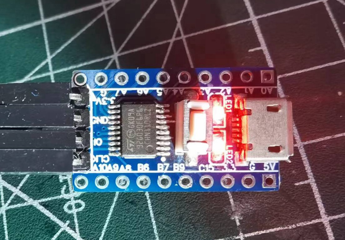

stm32g030f6 core board
This version is suitable for stm32G030F6, stm32G031F4, stm32G031F6, stm32G031F8 chips
The board is 25.4 * 15.2mm tight, matching perforated boards and breadboards
Except for PF2 (NST multiplexing), all pins on the board are lead out.
Reserved SWD burning port, you can use stlink-V2 to burn
Since I have all 0805 package components on hand, the board layout is a bit compact. It would be easier to change the 0603 package layout.
The logo was a bit upside down, this has been corrected in the release version.
