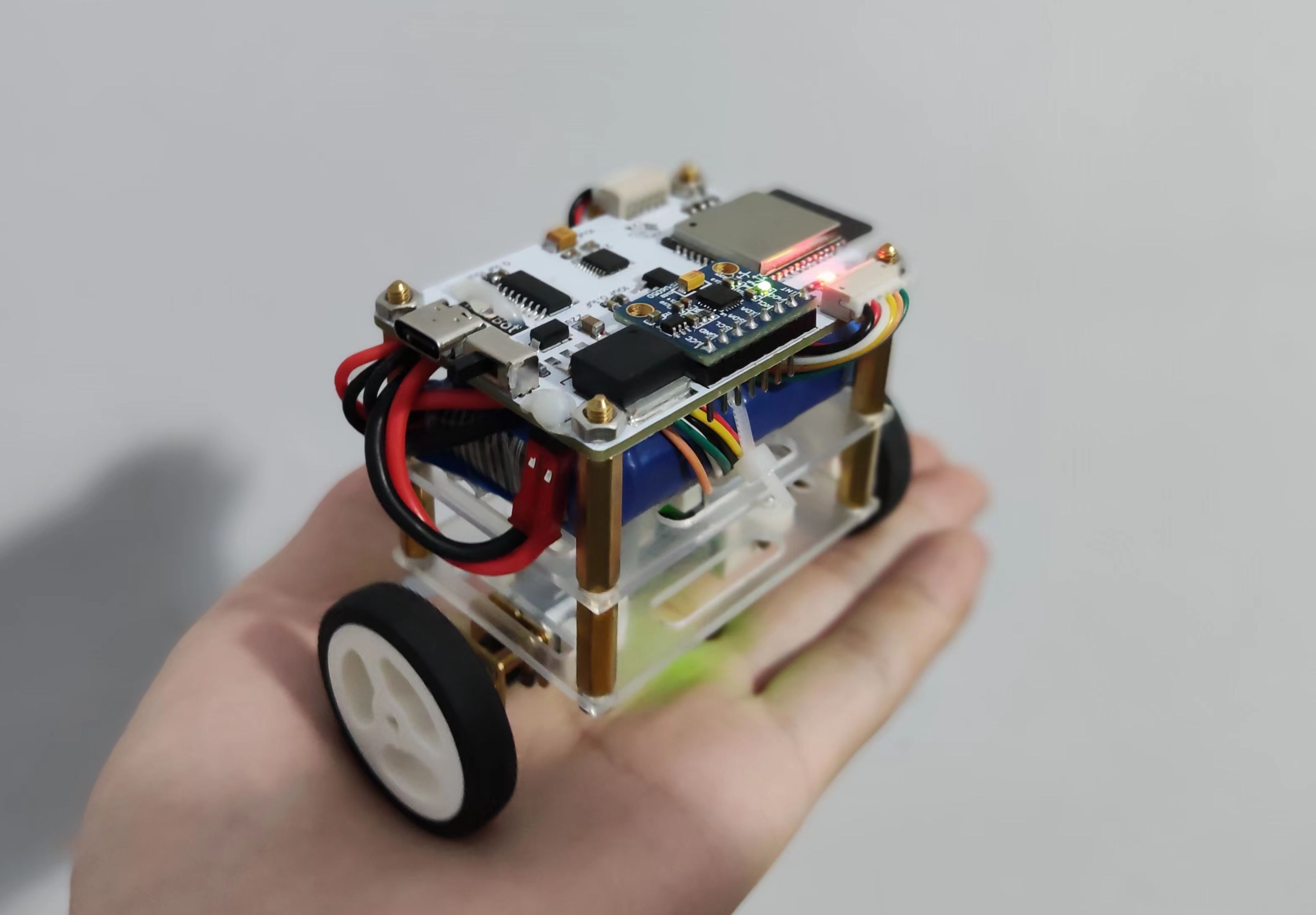

The balancing car is a must-do item for almost everyone who is into electronic DIY. It covers many fields such as sensor acquisition and processing, motor motion control, pid algorithm adjustment, etc. It is professional and interesting at the same time, and is very suitable as an introductory exercise project. After several version iterations (see subsequent introduction), this project was finally determined in its current form, which has achieved a good balance in appearance structure and software control, with a compact appearance and excellent sports performance.
Special Note:
  • There is a certain threshold for the circuit welding part of this project. If you are not sure about the welding of small patch devices , it is not recommended to try it . Or if you can make the board, choose Jialichuang SMT OEM, which saves you the trouble of soldering by yourself (the trouble of advertising fees) Knot it).
  • The principles of this type of balancing car are very similar, and they can also provide a reference for everyone to make their own balancing car. I am very happy to communicate and learn with you~
1.1 Basic introduction
ESP32-WROOM is used as the main control chip, and the MPU6050 six-axis acceleration sensor module obtains attitude information. The DRV8833 chip drives the motor movement and provides a large current. The motor uses an N20 reduction motor with an AB phase Hall encoder for measuring rotational speed. For power supply, a 7.4V lithium battery (2s) is used. The linear voltage regulator LM1084 is used to stabilize the voltage to 5V, and then the LM1117 is used to stabilize the voltage to 3.3V to power the ESP32.
The program is partially based on the Arduino IDE, using an open source library to achieve angle acquisition and pid algorithm balance control, using a JSON library to write an instruction parsing program for Bluetooth remote adjustment of pid parameters, and using the open source Android Bluetooth APP to remotely control the movement of the car.

Complete structural modeling : The original plan was to use two-layer boards stacked (such as the first version), with the battery placed in the middle. However, the motor cable needs to protrude upward, and the battery cannot be placed underneath, so an additional layer is added and a three-layer board is used. Stacked structure, the lower two layers are cut from acrylic, the uppermost layer is the circuit board, the battery is placed on the upper layer, and the lower layer is hollowed out to lead out the motor cable. The acrylic board also needs to add holes for the motor fixing frame, and arrange the motors as close as possible to reduce the Horizontal spacing. solidworks modeling is as follows:
In addition to the circuit board, there are only two identical acrylic boards that need to be customized, which can be customized by exporting them as DWG files from solidworks.

Component layout : Layout according to the main signal flow direction, mainly the power supply part needs to be concentrated to facilitate wiring. Some small devices are also placed in the blank space below the MPU6050 module, giving it a sense of 3D circuitry.
Manual wiring : The wiring is only usable, and there is still a lot of room for improvement. Then pay a little attention to the line width. The power supply part should be as wide as possible, and the signal line can be narrower.
My level of circuit design is limited. You are welcome to provide valuable opinions and learn and make progress together. Thank you.
2.2.3 Welding and assembly
During the circuit board welding test,
the CH340 was missing a capacitor (see the debug section). This version temporarily solved the problem by flying wires, and then fixed it with a piece of hot melt glue. Hot melt adhesive is also added to the power interface to prevent short circuits.
Overall assembly:
The lower two layers of acrylic board and the upper layer of PCB are connected and fixed with M3 hexagonal copper posts. The length can be as short as possible, but a certain amount of space is required for the battery and cables. The length used at the bottom is 15mm, and the length at the top is 20mm. The bottom motor uses the supplied motor base and is fixed with screws.
2.3 Debug records
  • The CH340 V3 interface lacks a 0.1uF capacitor for grounding, which prevents normal connection to the serial port. The current version can work normally after connecting the capacitor with flying wires. The PCB has been repaired in the v1.1 version.
  • The direction of the motor cable 6p socket is set in the wrong direction. The original design was to place it on the back, but according to the actual wiring sequence, it needs to be placed on the front . It has been marked in the v1,.1 version. Please pay attention to check, otherwise it may easily cause the risk of short circuit .

Structural level: At present, the miniaturization level has almost reached the limit (motor size limit). If it needs to be reduced further, it will have to be replaced with a smaller motor. From the appearance point of view, the biggest problem now is the battery wiring. Most of it is exposed to the outside, which reduces the aesthetics. At the same time, the motor cable is also relatively prominent. If it hits the cable when falling to the ground, it may cause damage. Consider replacing the connector with a straight pin. This can be solved by replacing the current curved needle.
Software level: In the first minute of PID operation, there will be obvious lag and overshoot in the motor movement. It will take a period of time to return to the normal balance mode. The reason has not been found yet. It is estimated to be a problem during the initialization of some variables. It is still being investigated. middle. There is still room for improvement in the stability of the car's operation. It is not very stable when stationary. On the one hand, the PID algorithm and parameters can be optimized. On the other hand, it may be affected by the encoder resolution. According to the 20Hz sampling rate, the encoder data range is 0 Integer values ​​around -50 have very limited data accuracy.
