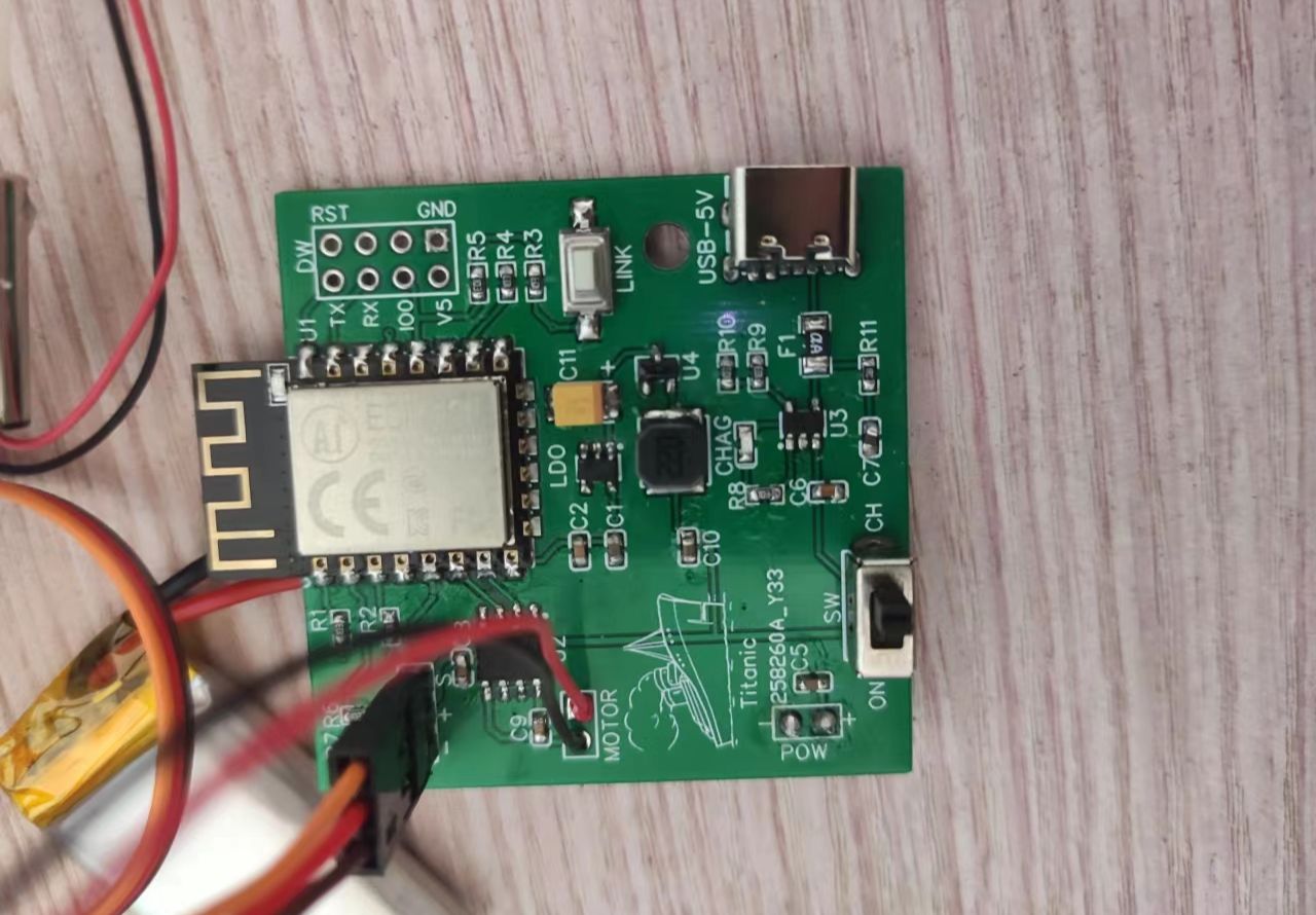

The boat uses esp12F as the main control and establishes a web service to realize mobile web control. Use coreless motors and servos to achieve steering and forward and backward control. The adoption goal is to be simple, cheap, playable, and reflect the DIY process. The oars are 3D printed and the hull is bonded with foam board hot melt glue - unsinkable. The hull can be designed by yourself. The program is designed for Arduino, the page is a static file, and the littleFS download plug-in needs to be installed.WeChat picture_20220715171637.jpg

The battery is 400ma, so two 10k resistors are attached (a single resistor patch saves money, there is no replacement fee and there is no need to waste the minimum number of posts), which is 5k, so the charging current is 200ma, as shown in the picture.
Engineering drawings are drawings of kt boards, which are used to make ships. The paddle file is used for 3D printing, boat.ino is the arduino file, and index.html is the control page. A plug-in is required to download to the esp-12F. There are play and design instructions in the schematic diagram, please read it carefully before use.
