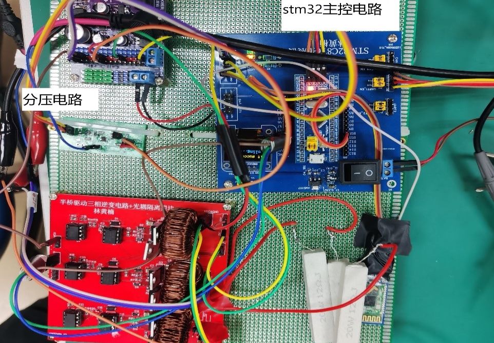

3. System appearance design
Figure 10 System appearance design
(1) Power module: The power module in the upper left corner is connected to a 12V DC power supply and can generate 3.3V DC voltage and 5V DC voltage to meet different requirements.
(2) stm32 main control circuit: The stm32 main control circuit on the right connects the Bluetooth module, OLED screen and voltage divider circuit, and simultaneously controls the normal operation of the optocoupler isolation + half-bridge drive module
(3) Voltage dividing circuit: The left voltage dividing circuit is connected to any end of the three-phase electrical output port, and is connected to the stm32 on-chip ADC after voltage division.
(4) Optocoupler isolation + half-bridge drive module: The optocoupler isolation + half-bridge drive module in the lower left corner provides spwm wave control to invert DC voltage.
