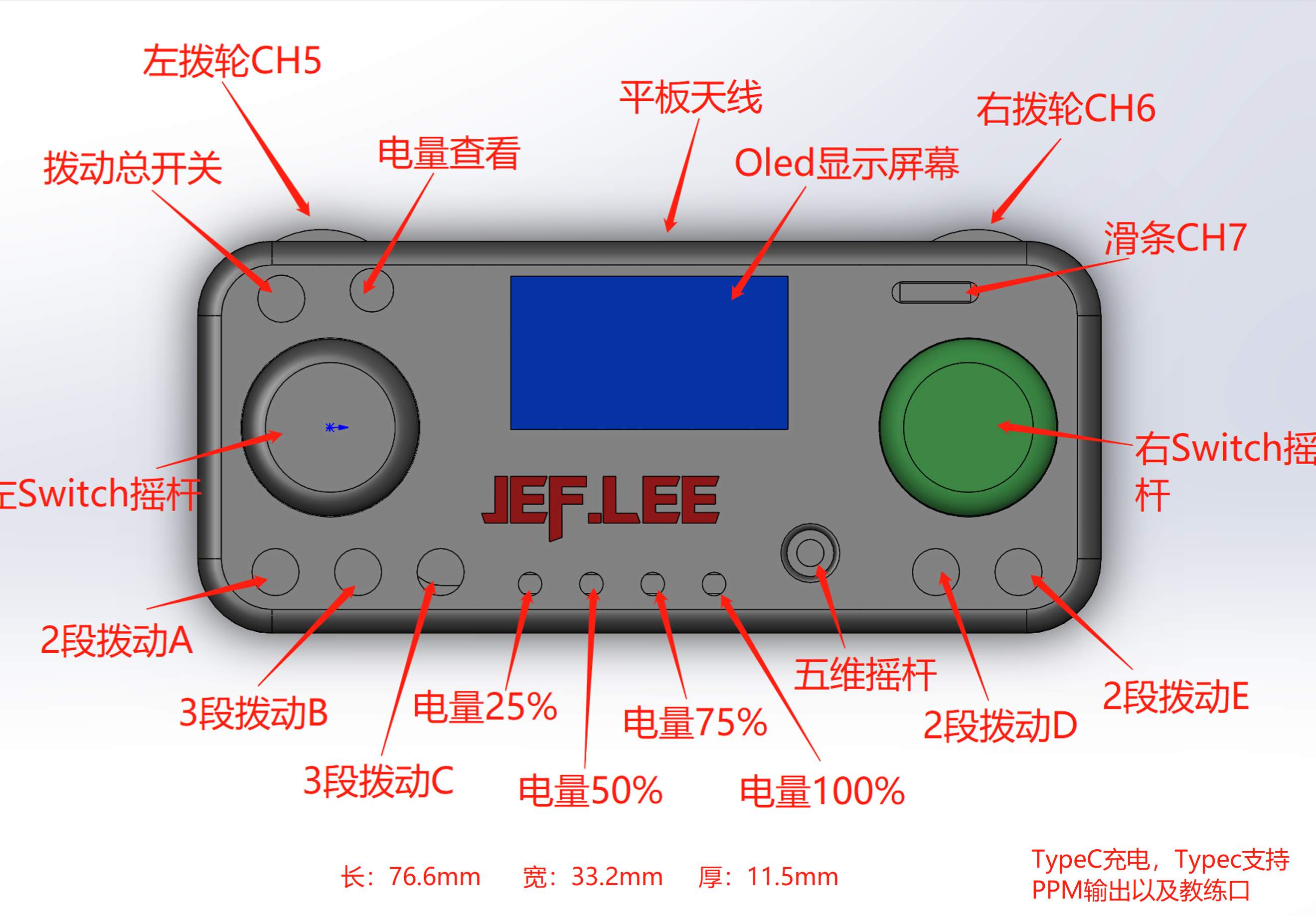

Loli third generation remote control-Loli mini
【Introduction】
An ultra-small remote control based on Loli open source, only the size of a lighter, including two pairs of rockers, 3 slide channels, 5 switch channels, additional voltage display, TypeC charging, and TypeC PPM input and output lights. The size is extremely mini, and the joystick is a Switch game console joystick, which has a good feel and accurate return.
PCB thickness 0.8, four-layer PCB board. At present, this one still has shortcomings that I am too lazy to bother with. The battery space is relatively small and the battery life is relatively short. Otherwise, the life of the rocker is relatively short and the accuracy error of the rocker is large. It is not recommended to play with model airplanes and drones. It is completely enough to play with model cars and ships.
【Update Log】June 21, 2022
I uploaded drawings in STL format for 3D printing. It is recommended to use nylon material with HP jet melting technology. I used 7500 black high-performance nylon from a certain factory. The accuracy of ordinary PLC is not enough.
I uploaded the firmware. Since I have changed so many versions of the firmware, I don’t even remember which one it is. This firmware should work. If not, please leave a message or send a private message. I update again.
Regarding the materials, in order to avoid suspicion of advertising. I won’t post the link, you can search for it directly.
Joystick: Japanese NTD or Japanese NKK small joystick, both three and two stages
Pulsator: gear dial potentiometer, volume switch, 103, 10K, 3 feet, dial diameter is about 15mm. Dial thickness 2mm
Screen: SSD1306 0.96-inch bare screen
Antenna: Built-in FPC antenna, size 10*37mm with adhesive backing, feeder length 3CM, frequency band 2.4GHz, IPEX1 generation connector
I have included pictures of other key materials, as shown below.
