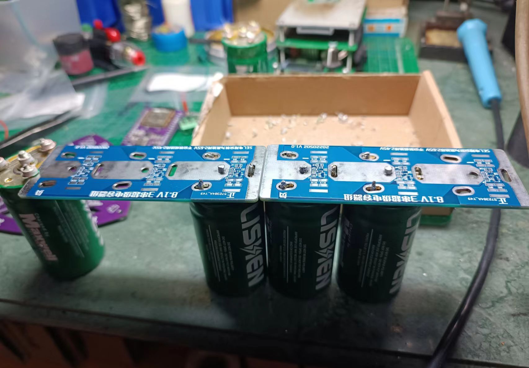

[Verified] 350F supercapacitor balancing protection board BW6101
This project modifies the self-confident entropy-generated light supercapacitor equalization protection board - Jialichuang EDA open source hardware platform https://oshwhub.com/FJ956391150/fa-la-dian-rong-jun-heng
For the convenience of making the board, it is changed to three strings. If you can connect six strings, it will be fine.
>2.75V indicator light will light up
6*2.7V farad capacitor capacitor bank balancing protection board,
Using 6 cells of Lishen 2.7V 350F supercapacitor in series is equivalent to a 16V58F supercapacitor.
Using BW6101 chip supercapacitor charging protection chip,
Built-in high-precision reference ensures output accuracy of ±1%.
The built-in power tube makes the leakage capacity after overcharge protection reach 0.7A@(VIN=2.65V),
which well meets the charging characteristics of supercapacitors when used in cascade.
