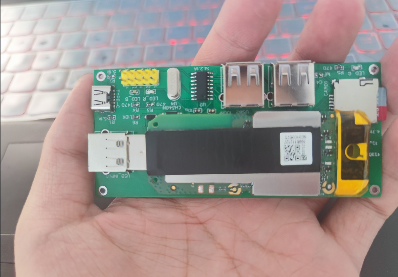

The USB Hub based on SL2.1A as the main controller provides an expansion interface for 410 devices. This expansion version is equipped with 2*USB2.0 interfaces, SD card slot (driver chip gl823k), and is equipped with a serial port driven by CH340N chip
Verified: serial port, USB port, SD card slot
Change log:
    2022.07.22 Complete schematic diagram and PCB drawing
    2022.07.23 Readjust PCB layout
    2022.07.27 Changed the positions of Type-C port and SD card slot
    2022.07.30 Changed the sd card module circuit
    2022.08.02 Changed PCB layout
    2022.08.05 Circuit verification passed
    2022.08.06 According to the suggestion of cool friend Zy143L, the front copper paving has been changed from +5v to GND
ToDo:
    1. Change automatic wiring to manual wiring (modify when you are free one day)
Physical picture 1Physical picture 2terminal display
PS: This is the first time for a mechanical engineering student to draw this kind of circuit. I welcome everyone to correct my mistakes.
