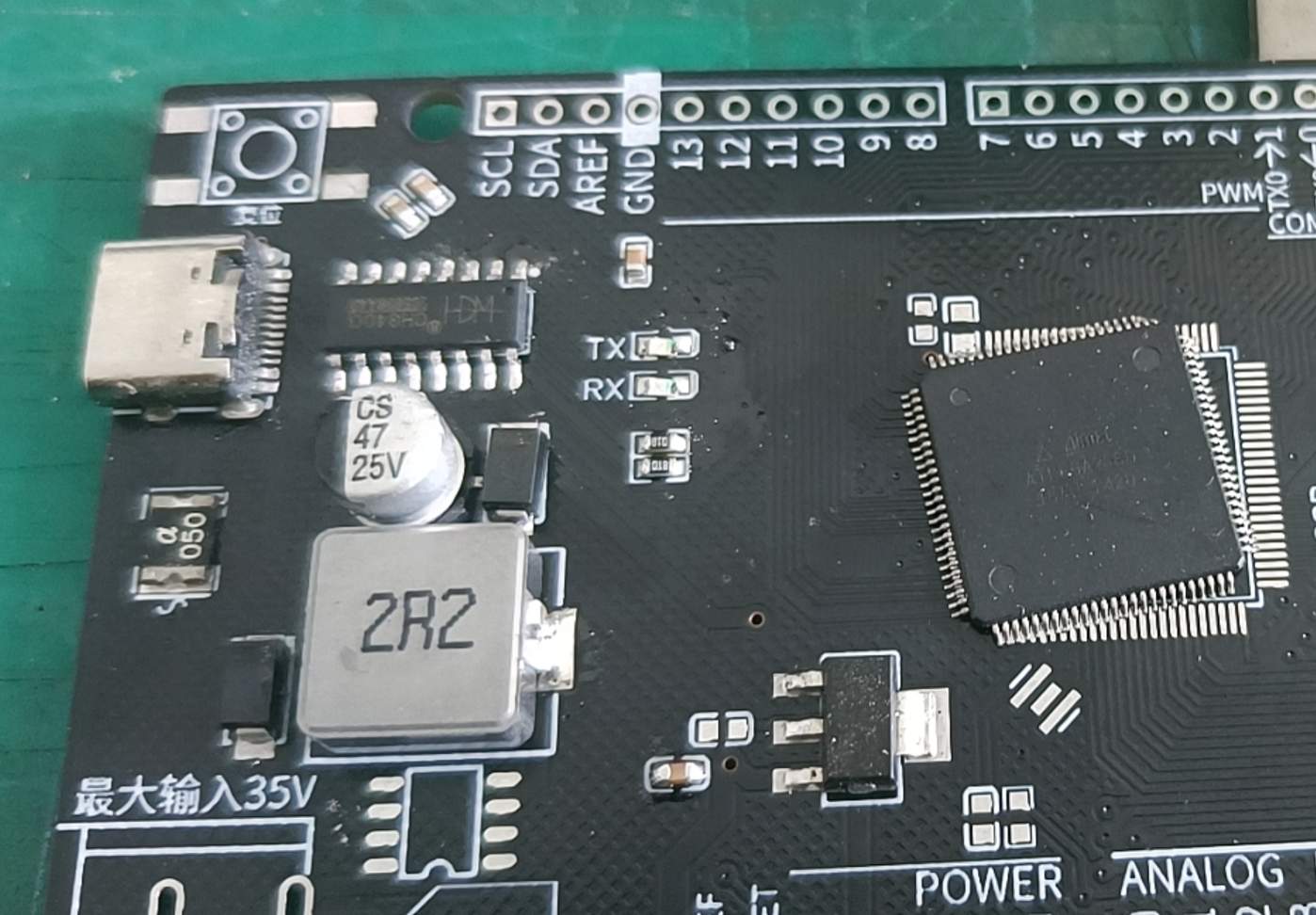

The power supply ripple measured so far is about 220mV at the extreme output (5V2A).
The test method uses the ground pin to be more accurate
Instrument: s350 changed to adjustable
ds1054z cracked ds1104z
4R cement resistive load (the instrument is very unbalanced, don’t curse)
2.5w working condition ripple 100mV
Ripple at 5w working condition: 132mV
characteristic;
1. The serial port circuit does not work when the dc socket is plugged in
2. bom minimalist
3. Powerful power supply 5V2A DC-DC 3.3V0.8A LDO (accumulated not exceeding 10w)
