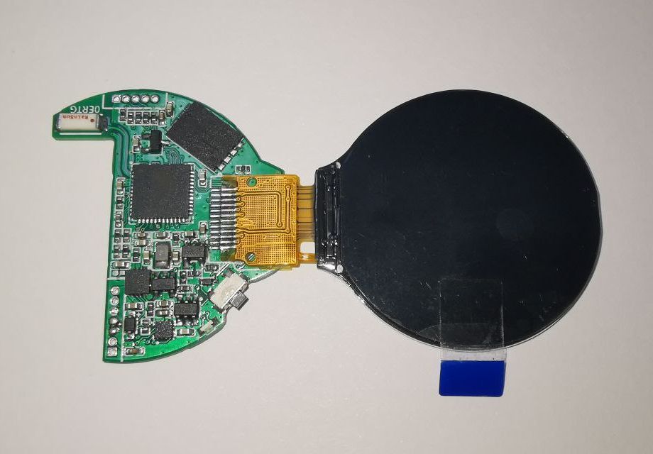

## ESP32-Vision V3.3 GC9A01 core board This is the V3.3 core board of [ESP32-Vision](https://github.com/libc0607/esp32-vision), adapted to the GC9A01 circular screen and [V3. 2 version](https://oshwhub.com/libc0607/esp32_vision_v3-2_gc9a01_rel), there are these changes: - The original toggle switch is replaced by a side-press micro switch. ESP32 identification - Added a light - Supports 4.2V/4.35V/4.4V lithium battery charging, configured through resistors - Optimized layout and copper laying This is not a complete project description. For more information about ESP32-Vision, see [Github project homepage ](https://github.com/libc0607/esp32-vision)
