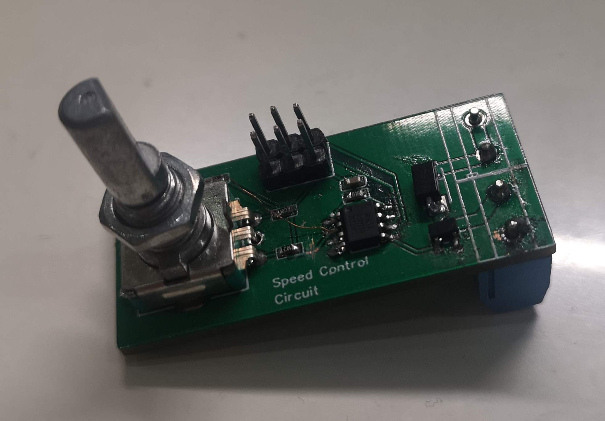

1.Design principle
As we all know, it is not difficult to use a sliding rheostat to adjust the speed of the ne555, but what about the encoder?
The principle of the encoder is to convert displacement into a periodic electrical signal, and then convert this electrical signal into counting pulses, and use the number of pulses to represent the size of the displacement.
Based on the particularity of the signal, the NE555 is no longer useful at this time and requires a microcontroller.
2. Component selection
Most of these products on the market use STM8 series microcontrollers, but our scenario does not require complex functions, only speed adjustment.
So I found the ATtiny 13A which is extremely cheap and supports Arduino.
The MOS tube is SI2308, with a continuous drain current of 2A, which can be replaced according to your actual needs.
The LDO is 78L05 with a maximum input voltage of 30V, which can meet the needs of most situations.
3. Programming
The program is written using Arduino IDE, and the burning file is attached.
4.Circuit characteristics
Output 75Hz square wave drive MOS tube duty cycle adjustment range 0%-100%
After a short press of the switch, the fan runs at full speed. Short press again to turn it off. Turn the encoder to the right to accelerate.
5. Physical picture
Don't scold me. There's nothing I can do if the board isn't tinned.
The video allows you to intuitively feel the fan speed adjustment and how bad the test version will be without the anti-bounce circuit (the official version has the anti-jitter circuit)
