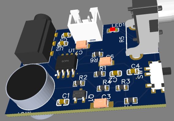

You don’t need to buy that connecting terminal, it’s for positioning. If you don’t want to use this switch, you can fly the wires (see the schematic diagram, there are only two wires)
By the way, the two microphones should not be too close to the board, otherwise they will not be welded together. Use a pipe to cover them as mentioned below (I plan to use the pipe to heat the melted glue)
In fact, the potentiometer is 47k, but I couldn't find it, so I used 50k, there is no difference.

BP is best to purchase matching microphones used in two-channel recorders, fix them on both sides of the printed board, and then put a plastic sleeve on the two microphones, with one end close to the hearing aid and the other end close to the printed board. . It is best not to make holes in the printed circuit board to prevent noise from entering the hearing aid box, causing resonance or causing an "acoustic short circuit" and weakening the noise suppression effect. BP has polarity, so it must be wired as shown in the figure to work properly.
