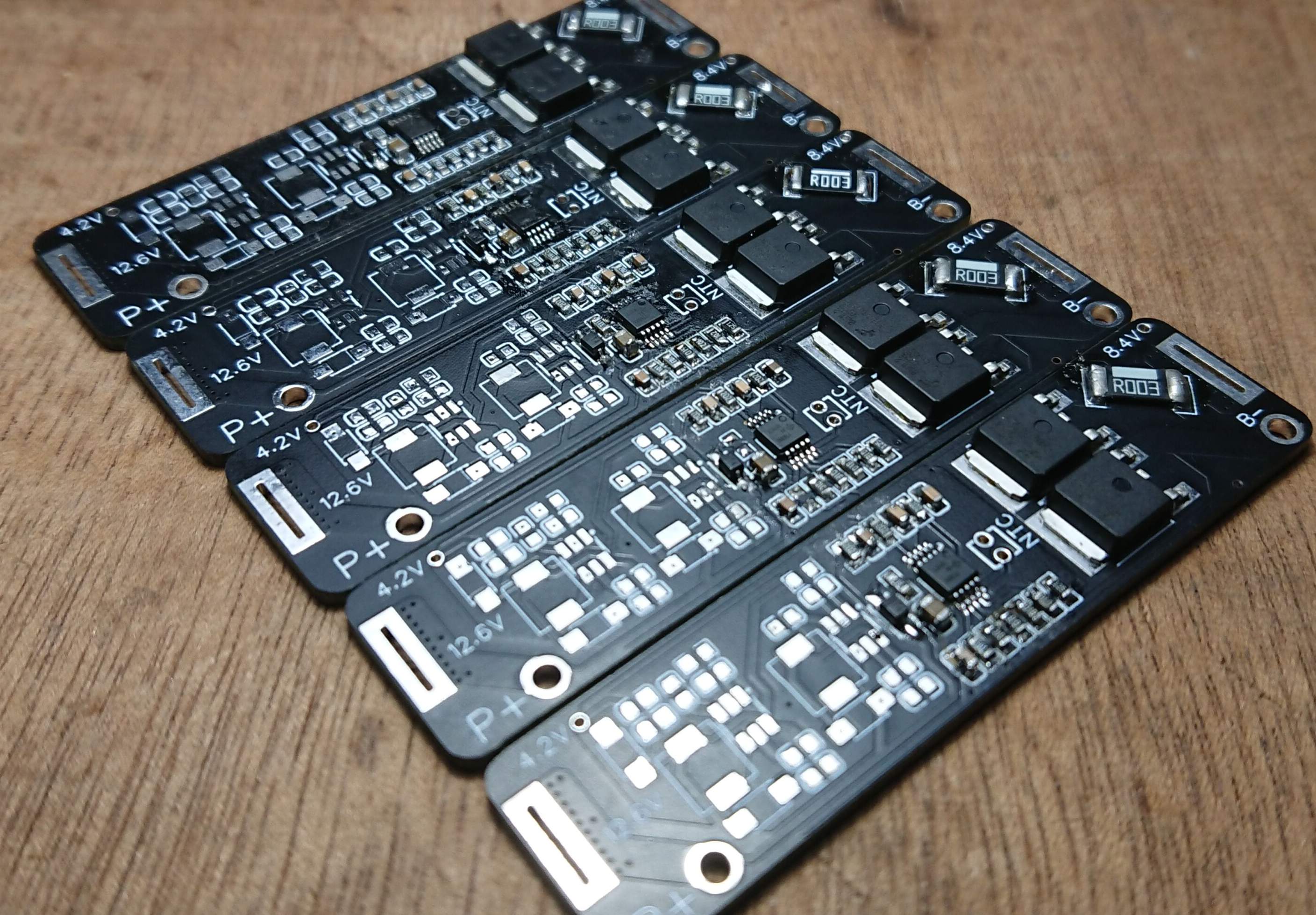

[Failed] PT6303 3-string lithium battery protection board (with equalization)
Without further ado, here are the pictures and links.
(It was 0.8 yuan a piece at the beginning, and I bought 10 pieces of music.
Note: R11 conforms to the following formula
R11=0.02/I passes
I over = over current
2022.8.2 update sent but no output
Note: The balancing circuit is not included in the schematic diagram. Just place the components yourself according to the prompts on the PCB.
