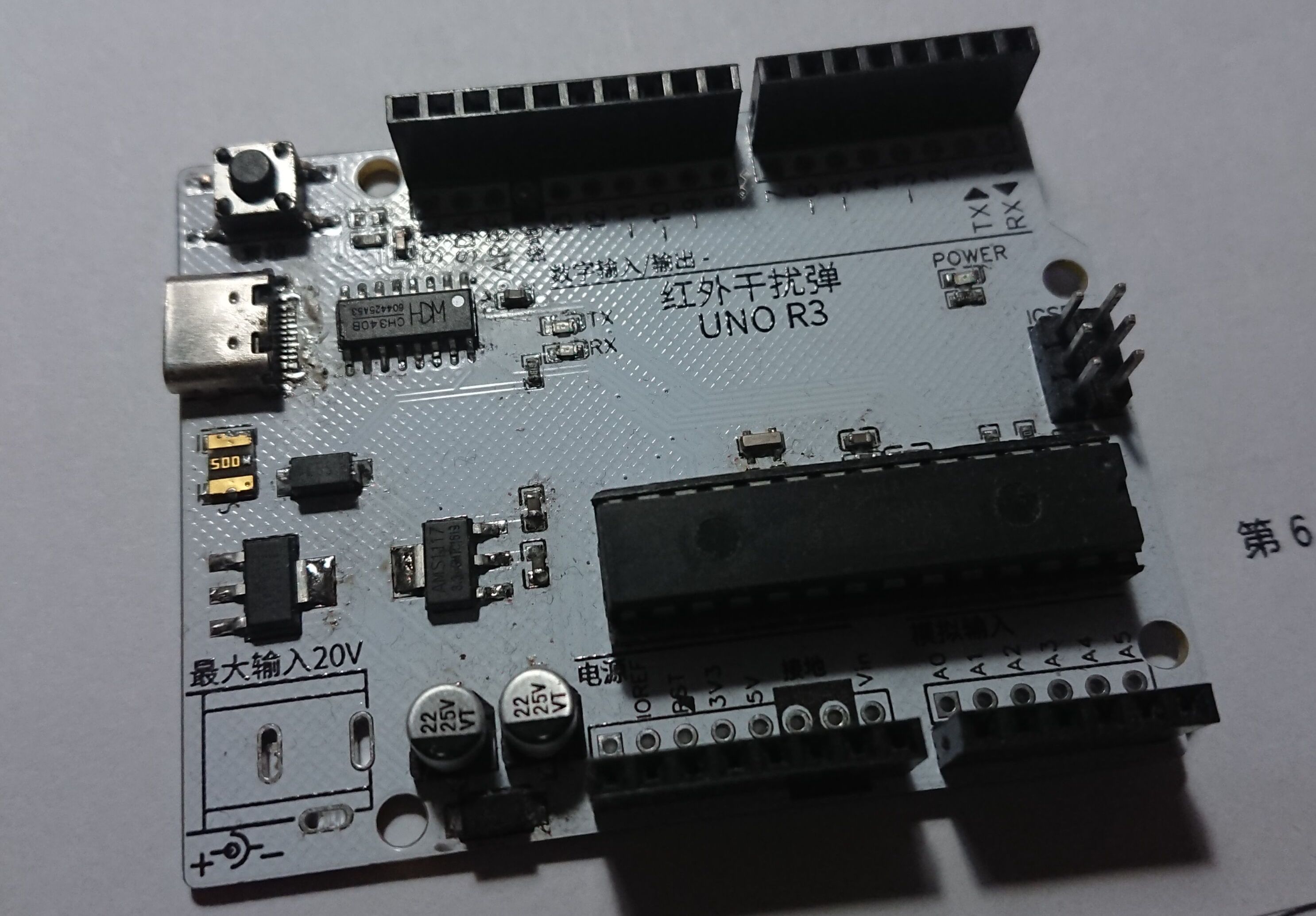

[Verified]Arduino UNO R3 modern upgraded version
The original uno uses a typeb socket. The cable is difficult to find and use. At the same time, the 16u2 chip causes some systems to not recognize it.
We often encounter wild 328P on the road, so we came up with such an improved version of uno
Features:
  1. Interface anti-backflow
  2. Type-C interface is more in line with modern people’s usage habits
  3. usb with esd chip, effectively avoid losses caused by static electricity
  4. ldo upgrade can drive more powerful peripherals
  5. Two rows of IO, one male and one female can be welded for easy debugging
参考设计图片
