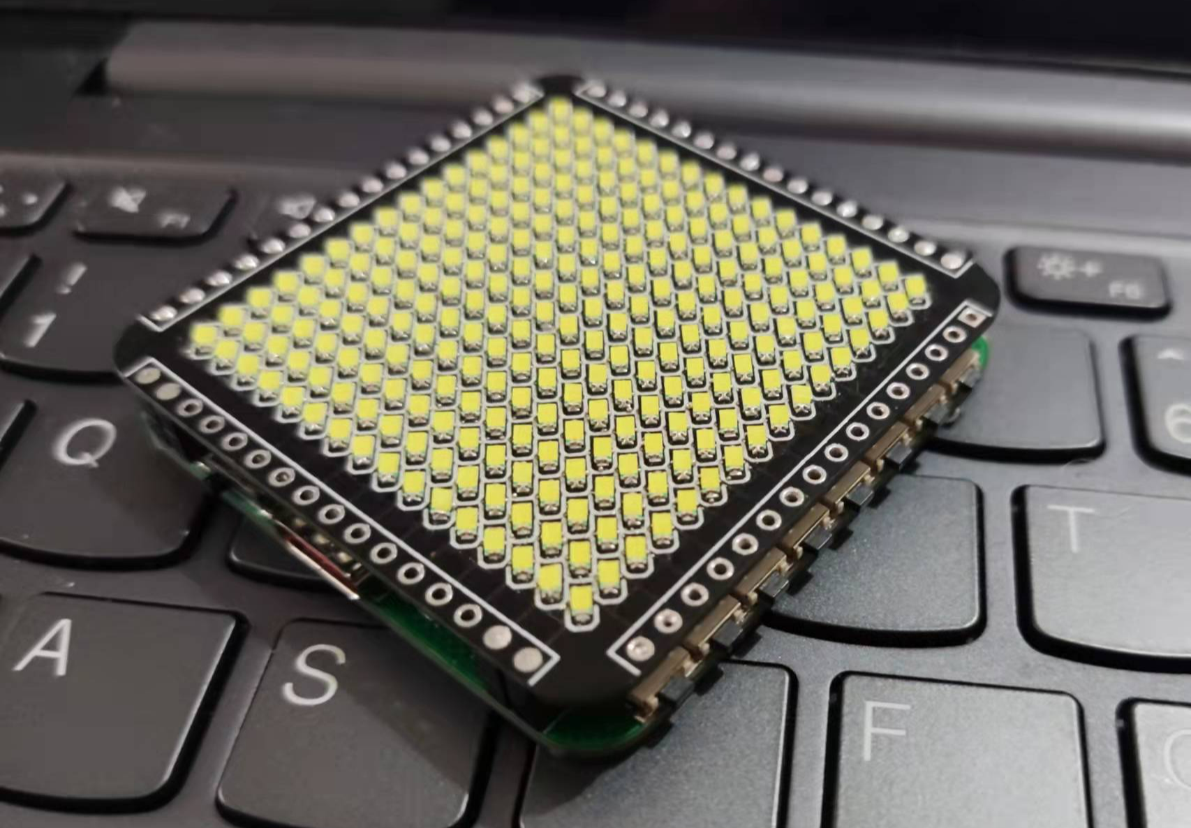

16*16 dot matrix screen, microcontroller control, with CH340 programming circuit, microcontroller model 15W408S, eight buttons and a main power switch, type-c power supply and serial communication, can run small games such as Tetris and Snake
I drew a 0603 package on the circuit, but I used a 0805 package when welding it. Welding 0603 may cause damage. The actual test of 0805 LED was no problem, because I have not tried 0603, so everyone should be careful in choosing the LED package type.
