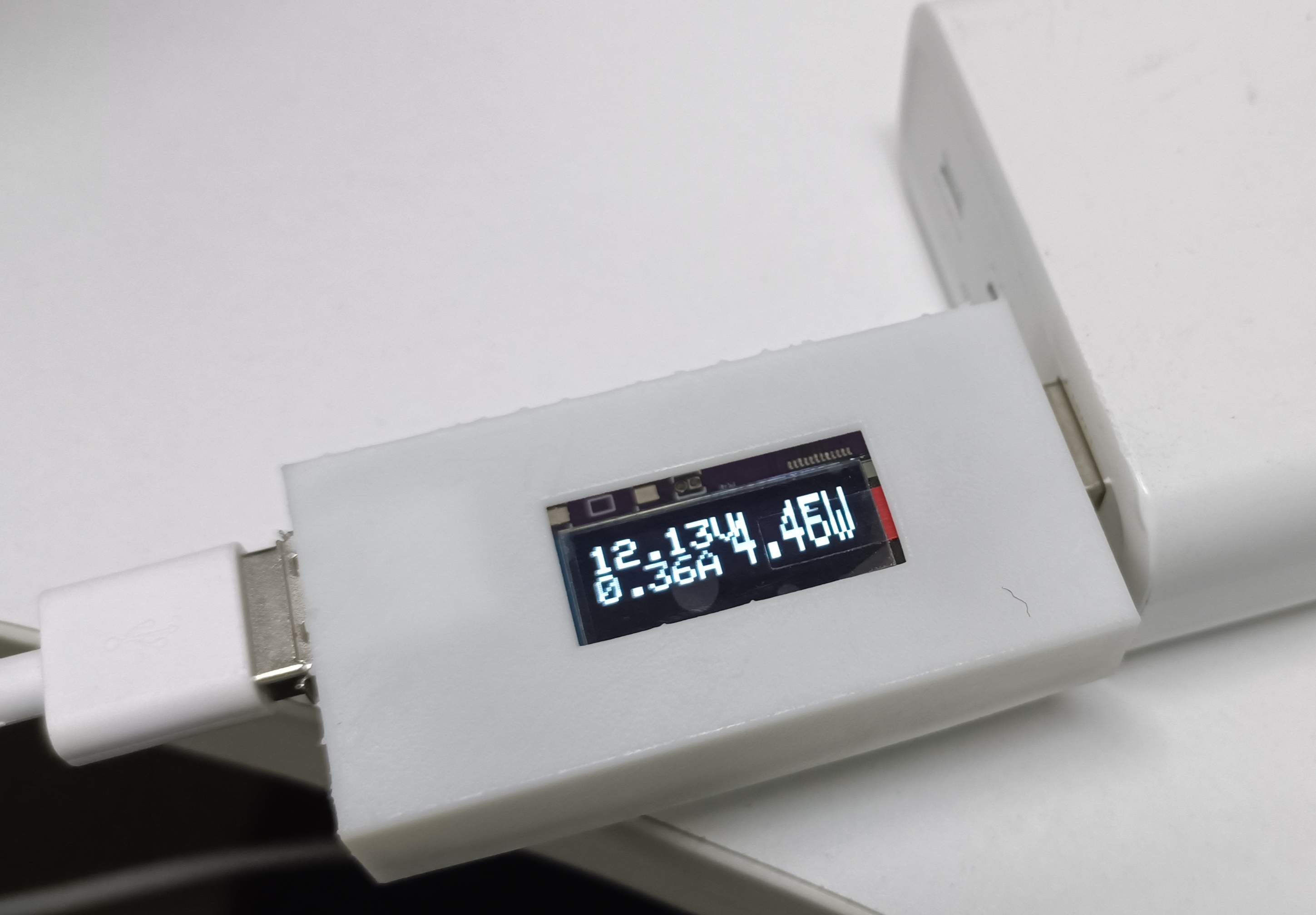

#The7thLiChuangElectricityContest#USB Ammeter
Introduction: Voltage and current USB power meter based on N32G430C8L7, small and beautiful.
1. Project Introduction
A small USB power meter based on the domestic N32G430 chip, supporting fast charging. With a 3D printed shell.

6. Physical display
7. Notes
The 3D printed shell cannot be fixed, I fixed it with tape.
