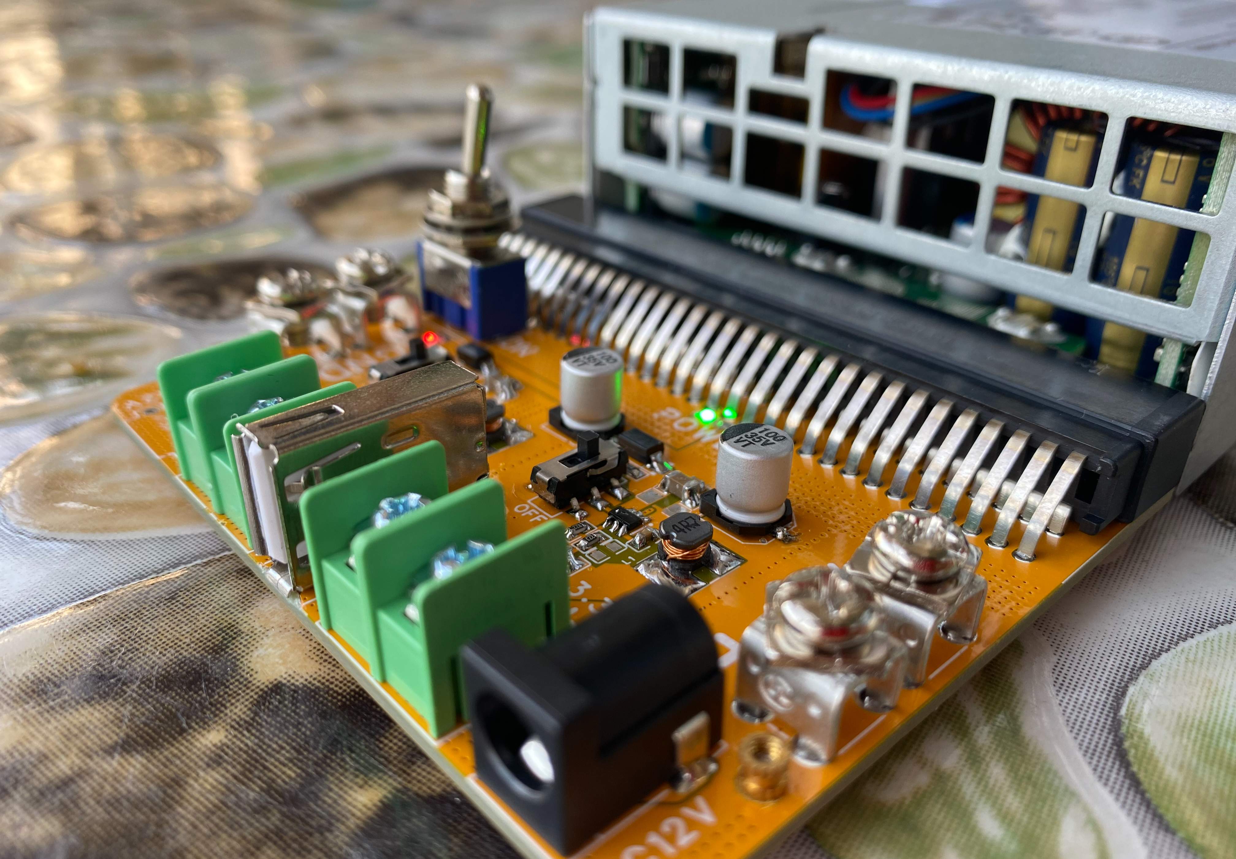

[Project introduction]
12V is a direct power output, which can be filled with tin through the window of the PCB board to improve the ability to withstand large currents.
The advantages of this chip can be achieved using as few external components as possible.
The DC-DC output voltage value can adjust the corresponding resistance according to your needs.
Output voltage range: 0.76V to 7V
[Details]
I personally like the feel of the button switch. Considering the cost, it can be replaced. It's OK as long as it can be connected! ! !
Slot model: WingTAT Noguchi S-64L-2.54-5 65P
[Output parameters]
The READY light is on, indicating that the power supply is connected to the mains power supply.
The POWER light is on, indicating that the main power supply switch (12V) is turned on.
12V; 62.5A Max
5V; 2.5A Max
3.3V; 2.8A Max
