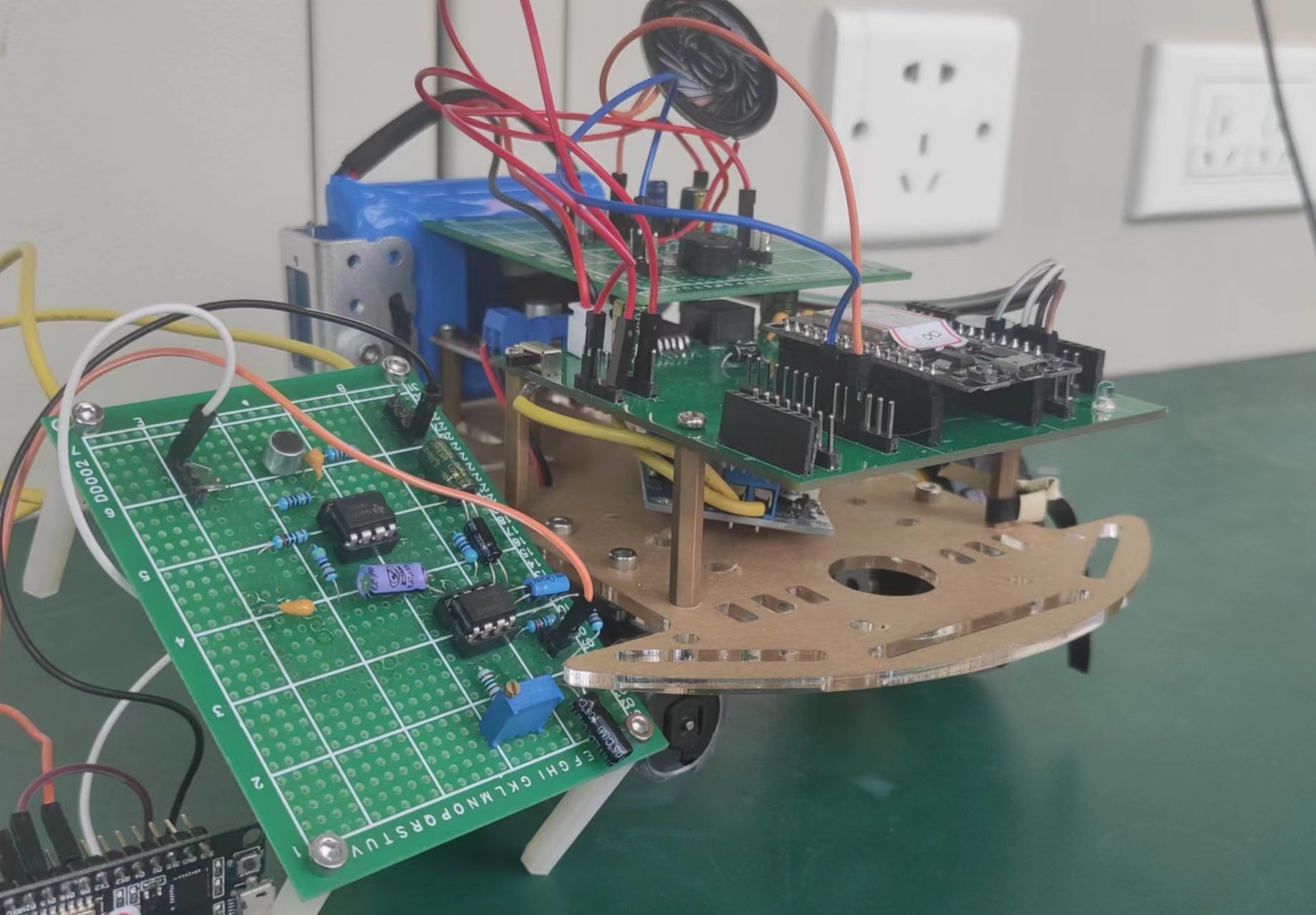

This system consists of two units: a movable sound source and three audio receivers with different orientations. Each unit is controlled by a low-power microcontroller ESP32, and the controller at the audio receiver is the main controller. The audio receiver can receive and process the audio signal emitted by the movable sound source platform, and guide the movable sound source to move along a designated route under the control of the main controller. The audio receiver is composed of an audio signal acquisition and processing circuit and a wireless transceiver module. The movable sound source uses a car as a platform and consists of an audio power amplifier, a light-emitting indicator circuit, a motor control and a drive circuit, etc.

1.2.5 Audio power amplifier module
LM386 is an audio integrated power amplifier with the advantages of low power consumption, adjustable internal chain gain, wide power supply voltage range, few external components and low total harmonic distortion. And the price is cheap, only a few cents a piece.
1.3 Overall summary
Through discussions within the group and the requirements of the topic, in the following article we generally introduce the structure of the smart car:
  1. ESP32 is selected as the master and slave microcontroller, and Bluetooth transmission is convenient.
  2. Motor drive module: Since the current output by the microcontroller is limited, it cannot directly drive the motor, so it needs to be driven through a professional circuit. This car uses the L298N driver chip to drive the motor.
  3. Power module: This design mainly uses rechargeable 12V lithium batteries. After voltage reduction and voltage stabilization, it can stably and safely power the motor and microcontroller.
  4. Wireless communication module: using ESP32 low-power BLE Bluetooth transmission

Using the LM386 circuit with a gain of 200 times, it can effectively amplify the output power of the microcontroller and drive the speaker.
3.1.2.Audio receiving module
Using LM567 frequency selection circuit, the effect is good, the original parameters used are all valid parameters, the error does not exceed 5%
Mainboard control circuit
The lm2596 is used to reduce the voltage to 5V as the power supply for the microcontroller.
Power module
A 12V rechargeable lithium battery is used to power the motor to ensure stable power supply.
3.2. Software design
Taking the arrival of the center line OX as an example, the host first transmits a signal through Bluetooth transmission to tell the slave to start the timer. The host emits a sound wave. Since the three pins of the slave are set to the falling edge, the interrupt is turned on. When a certain receiving hardware is received, turn on the interrupt and read the timer time. When all three are received, turn off the timer and compare the time of A and B. If the time to reach A is greater than B, the slave sends a forward signal to the host. , if the A and B times are within the allowed range, a stop signal is sent to the host to stop the car, and then the above procedure is repeated continuously. However, due to the interference of echo and other sound sources, the time judgment is inaccurate. At this time, the response time must be reduced and the sound frequency must be increased. The mean filter algorithm is often used to obtain a relatively stable time.

The frequency of the movable sound source audio signal is 6.4kHz, and the time period is set to 1s to sound once.
Assemble and debug all the hardware, and burn the written ESP32 into two ESP32 modules. Continuously correct and optimize Arduion-based programs according to the actual hardware conditions.

4.3 Test results
Since the distance limit of the hardware can only be guaranteed to be effective within a specific demonstration, the car can only meet the requirements within this specific range. At the same time, due to environmental interference, it is not guaranteed to completely reach the center line every time, and there are errors. And due to the Bluetooth pairing response speed, the overall pace is not very fast. Improvements can be made in the software.
