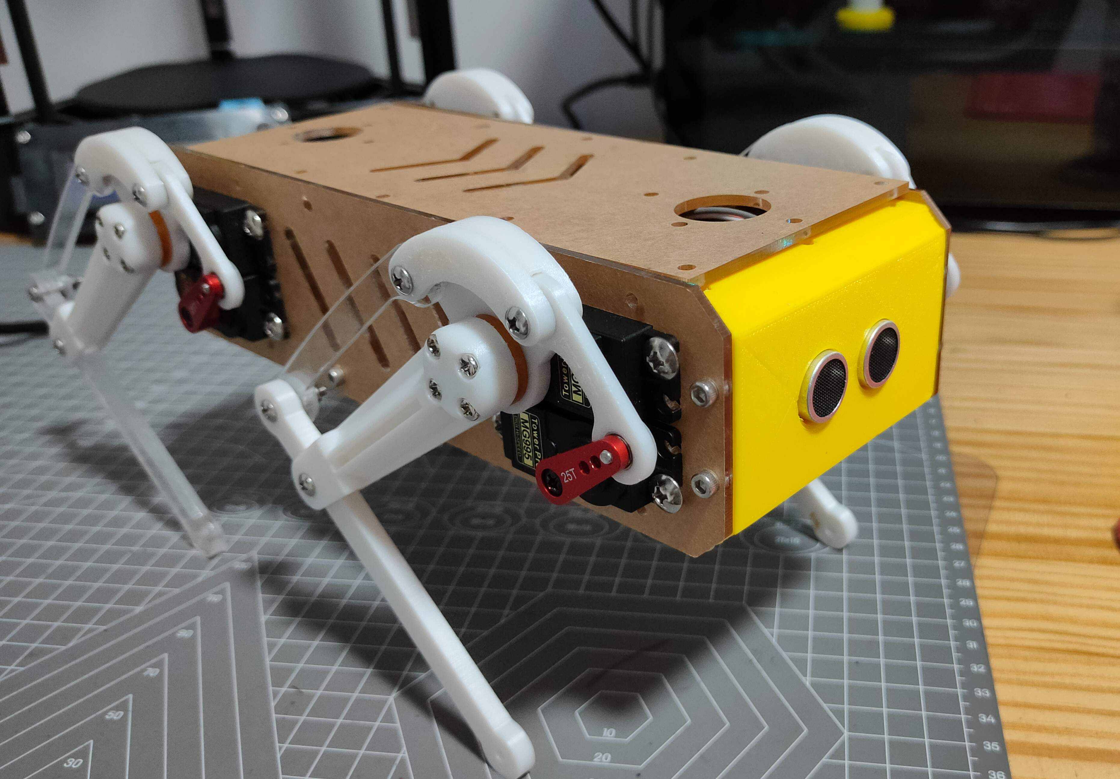

Bionic robot dog based on HiSilicon Hi3861 chip
circuit design
Leg 8-way servo drive + 8-way servo expansion interface
  • 2-way ultrasonic distance sensor
  • MPU6050 attitude sensor
  • Can be externally connected to ESP32-CAM to transmit real-time video
  • 2S lithium battery balance charging, using TP5100 solution
  • With battery voltage monitoring and charging status monitoring
The main control is Chuanzhi Education  ITCAST-HI3861 , which uses STC8G2K64S4 as the servo driver and ultrasonic ranging. STC8G2K64S4 and MPU6050 are connected to ITCAST-HI3861 as slaves through the I2C bus.
structural design
The structure is designed and simulated using Creo software. The fuselage structure uses 3mm acrylic panels, the rest are 3D printed parts, and bearings are used in the joints.
Material costs

Physical display
There is a problem
  • After the actual installation, with the battery in hand, the weight exceeds 1KG. Replacing the acrylic shell with a carbon fiber board should reduce a lot of weight and increase strength.
  • The current continues to be around 2A during operation, and the battery life is poor when using a 2200mAh 7.4V battery (it is later envisaged to add a wireless charging module to the chassis and automatically navigate for charging).
  • Because the lithium battery charge management chip TP5100 was burned during the debugging process, the lithium battery balance charge and discharge could not be tested.
