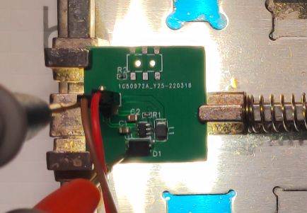

PAM2803 test board
## According to the schematic diagram and PCB board implemented in the official document, the board has been successfully tested. ### Known issues* Common DuPont lines have a large voltage drop. When using a single dry cell battery, the voltage drop on the board is likely to be about 0.8v under high current conditions. The circuit will work unstable, causing flickering and failure to shut down. You can use good wires yourself or solder other wires.
