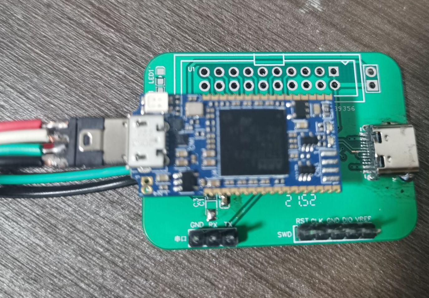

ST-Link V3 mini to JTAG SWD
Convert ST-Link V3 Mini's STDC14 to JTAG and SWD. This adapter board can power the target board. You need to solder the pin header to the hole on the left side of the JTAG interface and connect it with a jumper cap. ![image.png]     There is no need to power the target board, and the entire 5V to 3.3V circuit does not need to be soldered. Note: You also need to add the mrcio USB male connector to the BOM table (the rear 4-pin soldering wire version is enough)
