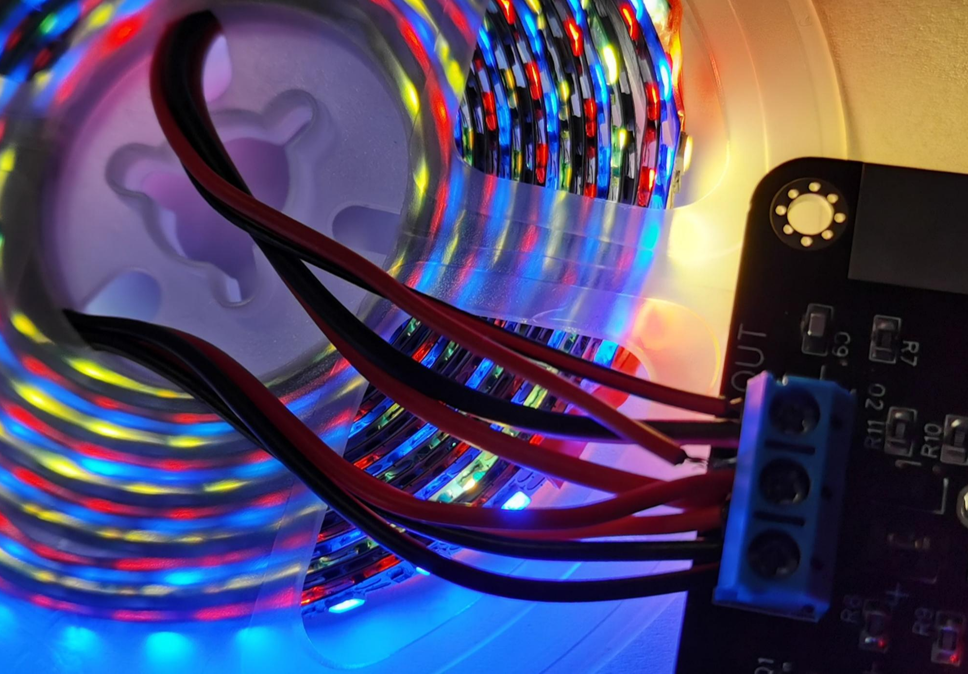

A two-way light bar button touch panel controller based on the Renesas R7FA2E1A72DFL#AA32-bit series microcontroller .
Chip characteristics
R7FA2E1A72DFL#AA is the entry-level single-chip microcontroller of the RA series, based on the 48 MHz Arm® Cortex®-M23 core, with up to 128 kB of code flash memory and 16 kB of SRAM. This product uses an optimized process and Renesas Electronics' low-power process technology. The product supports a wide operating voltage range of 1.6V to 5.5V and a variety of packages, such as LQFP, QFN, LGA, BGA and WLCSP. The RA2E1 is pin- and peripheral-compatible with the RA2L1 product group, making it ideal for battery-powered and space-constrained applications, as well as other systems requiring high performance and low power consumption.
48MHz Arm® Cortex®-M23;
Wide operating voltage range of 1.6V - 5.5V;
Enhanced capacitive touch sensing unit (CTSU);
Independent SPI interface/I2C multi-master interface;
12-bit ADC, LPACMP, temperature sensor;
32-bit general-purpose PWM timer, 16-bit general-purpose PWM timer, low-power asynchronous general-purpose timer;
Introduction to the functions of the work
Two power inputs (TYPE-C and 2PIN binding posts)
Input voltage: 1.6V - 5.5V
two-way PWM output
Potentiometer dimming
Three-way capacitive touch button
Control instructions
T0 switch (default output heating and cooling 1:1)
T1 cold light 3-level adjustment (output out1: out2 1:0.8 1:0.6 1:0.4)
T2 warm light 3-level adjustment (output out1: out2 0.8:1 0.6:1 0.4:1)
(The touch doesn’t work, it’s useless)
Someone can increase the sensitivity of the program. Now it can be done occasionally.
Potentiometer to adjust brightness (5 levels) (useful)
