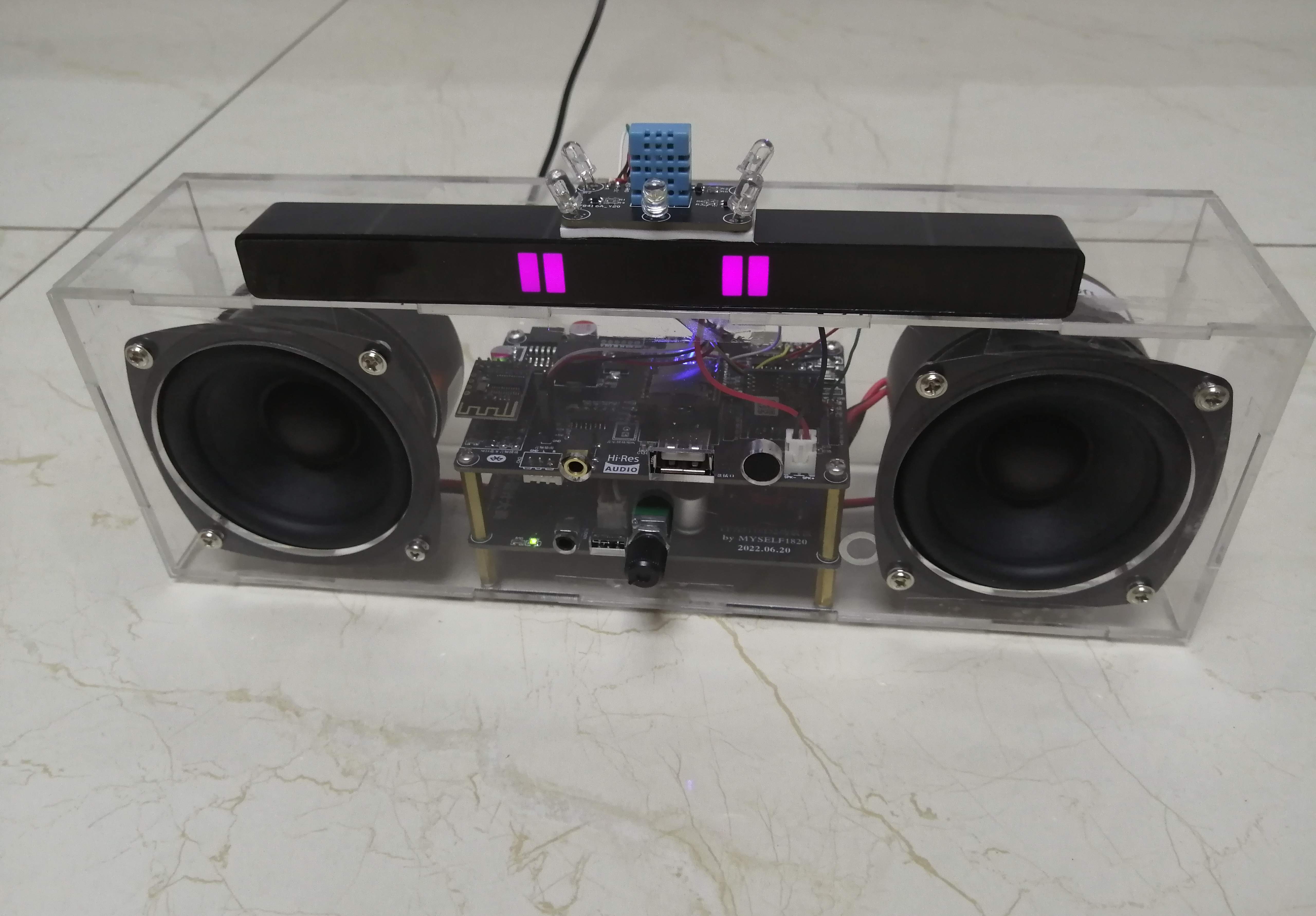

The power amplifier at home is not intelligent. Every time I want to listen to music, I have to turn it on manually, which is very troublesome. There is also a Xiaodu speaker, which is very convenient for listening to music and has powerful functions. The only drawback is that the speaker effect is average and it is mono. Therefore, I suddenly had the idea of ​​making a smart speaker, which integrates the power amplifier and the music playback circuit of offline voice control. It can play MP3 and mobile phone Bluetooth songs, control the infrared remote control appliances at home, broadcast the temperature and humidity in the room, and control the music rhythm light, so that I can feel more when listening to music. The circuit
adopts an upper and lower two-layer board design, the lower power amplifier board, the upper main control board, the power amplifier with two 15W full-range speakers, an external music rhythm light and infrared emission and temperature and humidity module circuit.

Main control board: mainly includes ESP32S, MP3 music module, M18 Bluetooth audio module, VCT1 offline voice module. The audio of MP3 music module and M18 Bluetooth audio module is connected to CD4052BM multiplexing chip, and the common output is connected to the internal audio input interface of the power amplifier board through audio plug or connection. The audio of MP3 music module or M18 Bluetooth audio module is output by controlling the high and low levels of AB pins of CD4052BM.
The power supply part uses LM2596S-5.0, with input voltage of 18V, output of 5V, and output current of up to 3A (some people may ask why LDO is not used, because the output current is not enough and the heat is serious). There is a problem with using DC-DC, which will affect the audio circuit. The only solution is to add more filter capacitors. The design was not well considered at the beginning, and the filtering was not done enough.
The high and low levels of PWM4 and PWM5 outputs of VCT1 offline voice module are used to control the power supply and mute of the power amplifier. Voice commands communicate with ESP32 through serial port 1 of the module. The microphone is directly soldered on the board, and the module uses an 8 ohm 2 watt speaker for voice broadcasting.
There are some problems with the circuit design of the MP3 audio module. The actual circuit cancels the power control circuit and directly shorts the 5V power supply to the 5V positive pole of the module power supply.
The M18 Bluetooth audio module needs to be controlled by a button or a mobile phone. Here I use a set of triode circuits to simulate the button and control it through the ESP32 four-way IO.
CD4052BM can actually input 4 channels, but only two are used here.
The SPI screen interface is reserved, but it is not used yet. The screen can be added later.
The infrared emission circuit and the temperature and humidity sensor are led out to facilitate installation on the shell, and at the same time prevent the circuit from heating and affecting the temperature and humidity sensor.
Amplifier board: The audio power amplifier uses TPA3116D2DAD, and the pre-stage uses NE5532 amplification circuit. The audio input of the amplifier can be external input (external audio plug) or internal input (audio output line of the main control board), which is specifically controlled by a double-row two-speed switch.
The power supply of the amplifier is controlled by MOS tube, and the power supply control and mute control interfaces of the amplifier are led out
